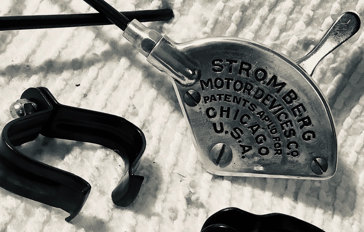

New version Choke for Stromberg OF?
Post by Dropacent » Mon Jan 18, 2021 10:55 pm
This is the new, cheaper version of the Stromberg choke control. Less parts, less work, less money, better unit. I’ll put an ad in the parts for sale, thanks.

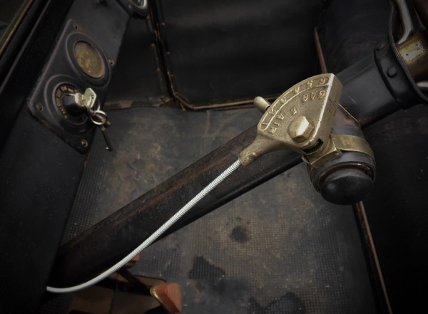

Mark Osterman
Posts: 1014
Last Name: Osterman
Location: Rochester, NY
Re: Cockpit Choke for Stromberg OF?
Post by Mark Osterman » Tue Jan 19, 2021 5:59 pm
Here is a vintage column control I use for either an OF I have or the U&J I’m currently using. It comes in very handy when starting in cold weather. You can gradually back off on the choke as the engine warms up.

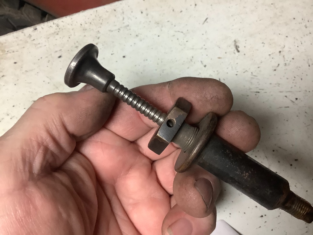

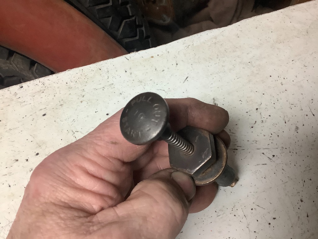

Dropacent
Posts: 3384
Last Name: Morsher
Location: Norwalk Ohio
Post by Dropacent » Tue Jan 19, 2021 7:07 pm
Here is a pic of one similar to what Allan mentions. Not sure who made it. A spring loaded ball holds it in place. Also, showing an ad for the type that Mark is using. These were made and offered by Schebler. Don’t know why , but I’m drawn to choke controls. Maybe because the originals are so hard to find. Shameless plug. We have them for Carter, Zenith, Stromberg and Schebler. The Schebler looks great polished up in brass , especially with it’s brass wire tube, on a brass T

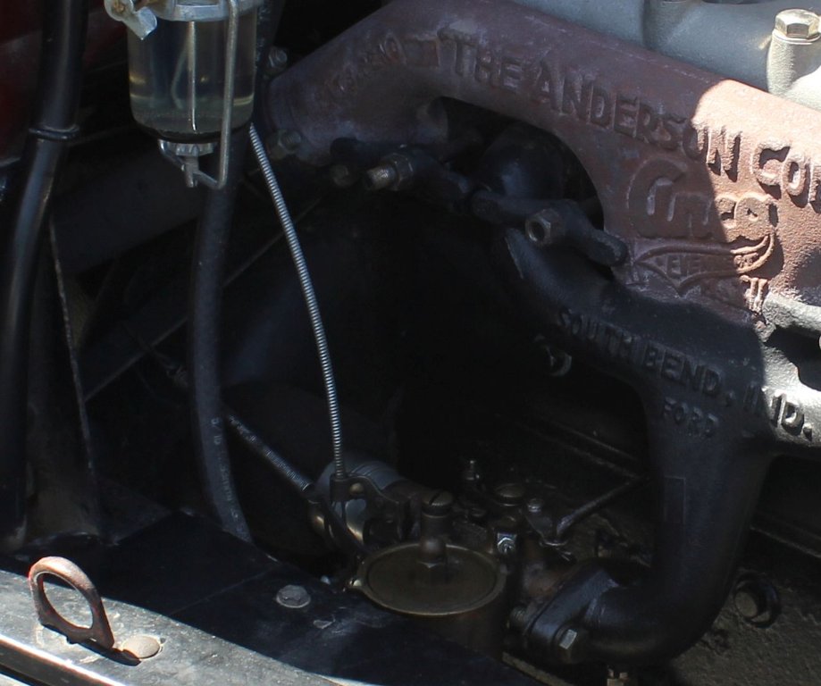

Posts: 7192
Post by Allan » Thu Jan 21, 2021 10:21 pm
My push-pull Stromberg alternative can be mounted under the steering column or on top. Underneath brings it close to the lever quadrant, so i mounted it on top. The wire wound cable housing is stiff enough to hold its shape. I routed it through the lower hole which is used to mount the bell crank on a standard choke mechanism. This is on a RHD car, making it dead simple. You would need a longer cable for a LHD car, and this may have to be anchored somewhere along its length for it to function properly.

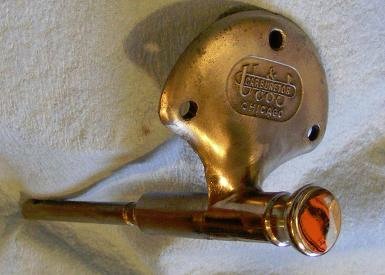

StanHowe
Posts: 979
First Name: Stan
Last Name: Howe
Location: Helena, MT
Post by StanHowe » Fri Jan 22, 2021 9:18 pm

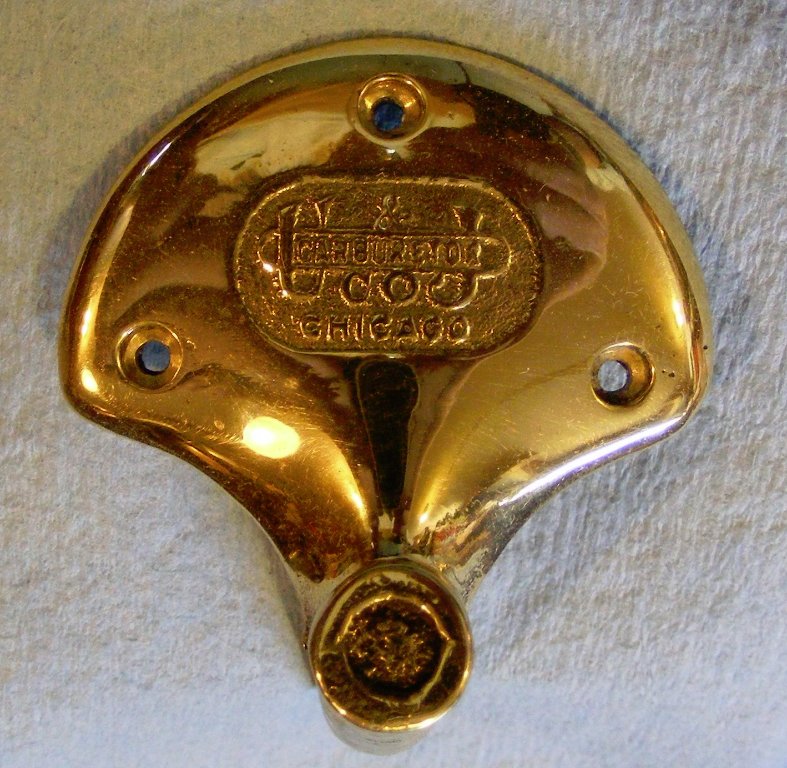

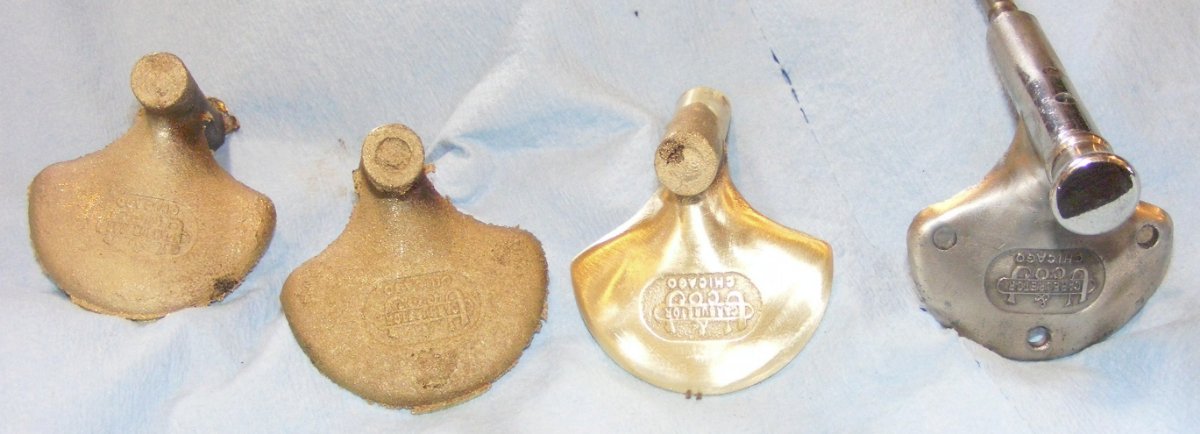

The original Stromberg connector is a brass tube similar to standard brass tubing with a wire inside it. It works pretty well but only if it doesn't have any fairly sharp bends. The newer ones have a standard wire cable with a wire inside, just like the choke and throttle cables, heater controls etc, used on cars in the 40's and up. Some use a motorcycle type cable like a motorcycle clutch pull cable.
The coolest one, IMHO, tho, is the U & J control. Mike Lebsack and I reproduced those a few years ago. I'm out of them except for one I kept. I also have the only known NOS U & J carb which came with the original we used to repop them. On the ones we reproduced I changed the ball stop to make it easier to assemble with out a special tool. I need to get more made.
