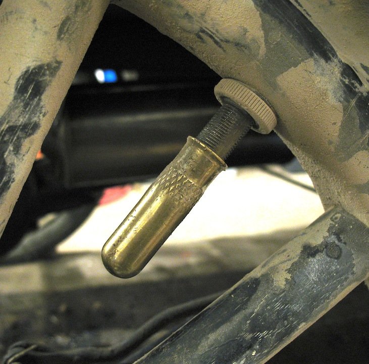

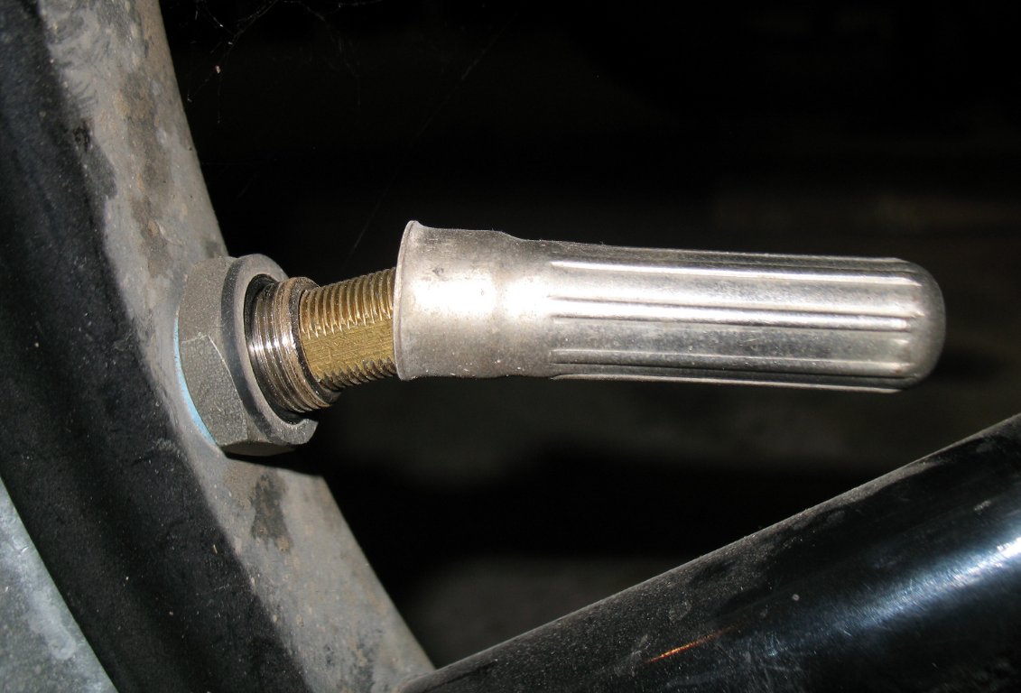

Here's a valve stem cover and a rim nut, brass version. Larry will tell you this is not correct, and he's right. The modern metal stems, and the originals I use, are larger than the Schrader 777 used by Ford. As Dude Lester said, "It don't hurt the runnin' of it none."
One of the many styles of nickel era dust covers and rim nuts. This is incorrect (oversize) too.

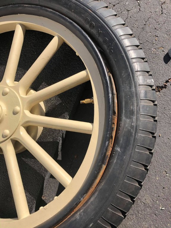

Hi Eric, at my first glance at your picture, the bead seems to appear a damaged and cracked? If the tyre is old and hard it will not cope well with the leverage required to get it on and the levers will damage the bead. I would not trust a tyre that has a cracked or damaged bead. Hopefully I am wrong, but the brown rust marks and cracks indicate it is an old hard tyre and will require very gentle persuasion rather than heavy levering to get it on. Talcum powder or tyre lube is a great help getting the bead over the rim also. I find doing it with the wheel still on the car is easier.
- Posts: 7403
Re: Trouble Mountaing a Tire on a Non-demountable Wheel
...the bead seems to appear a damaged and cracked?
Not only the bead. It looks like the sidewall is cracked too. If this is an old, hard tire, as it appears to be, that would explain the difficult mount, and I wouldn't trust it.

Yeah, the bead on this tire has taken a bit of damage from repeated attempts to get it onto the rim, so I was considering replacing the tire anyway at this point. I was hesitant as there seems to be a consensus that new tires aren't quite as good as the older ones, and these ones certainly are older. Wards Riversides made in New Zealand which I think dates them sometime around the 1980s. I guess that's a good lifespan
