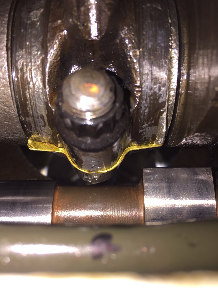

Trying to read up on, and head off any issues with a stroker build, I read about a possible interference issue with the Scat stroker cranks and new Stipe cams where the counterbalance or rod would touch the cam. Apparently didn't happen with reground cams.
Is this happening? Or did someone just linebore the block too close to the cam? If it is happening, what is the solution without screwing up the timing gear mesh?

I did the stroked scat crank and 280 stripe cam 4 years ago. I had to relieve the engine block and form the oil return line so they crank didn’t hit but no problem with the cam. BTW I wouldn’t do the stroker crank again. I don’t like grinding away at the engine and that ugly pan spacer. I don’t feel much performance increase. I would have been way happier with a stock stroke scat.

This engine is being built to haul a heavy load of camping gear, and two large guys, up steep grades. I'm looking for torque, and larger, stronger journals. I'm really after the larger journal size than the extra stroke. And I'm aware of the work required to stroke the engine, but there was a mention of the new cams being just large enough that they interfered with the stroker crank in an old post, and if it's true, that would require relieving the crank counterweight or rod. And if I had to do that, I'd want to know it before the first dry fit.

Here is a pic of a Stipe .280 cam up against a shortened model A crank. There is about .100” clearance between the top of the rod and the root diameter of the cam. And about .300” clearance between the crank and the cam lobes. If there is a clearance issue, I would assume it is with the rods
