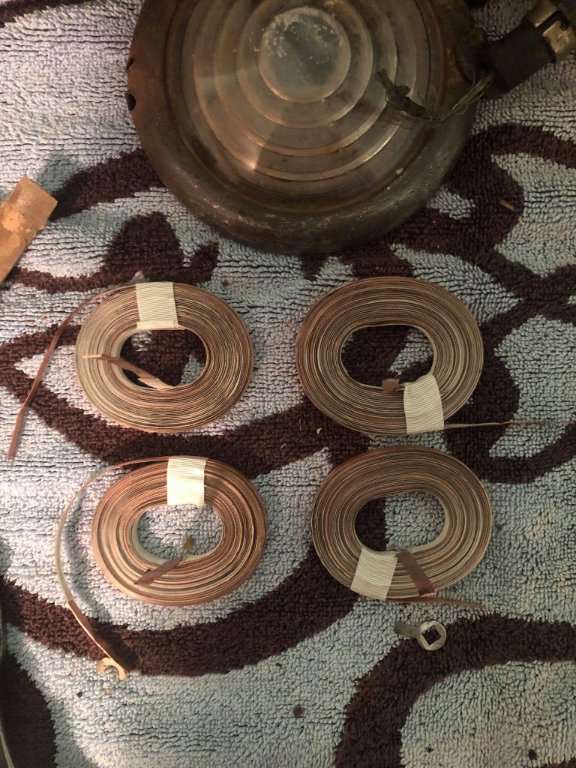

I'm finally able to carry on with my field coil rebuild. So far, I've done four of the sixteen, all of which are clockwise wound with the tab up. And, my fear has come true. The coils don't all finish at opportune lengths, some to worse degrees than others.
The top right one to me is ideal with the end to the right of the upward facing tab. My first one (top left) I made the center tab way too long, and are short by about half a turn. The bottom two are close, but they seem too far back to be able to make a splice.
My question is, can I just unwind what I've done back half a turn to an ideal position? This way, some coils may have more turns than others. As long as they alternate CW, CCW, CW, CCW etc., is that really an issue?

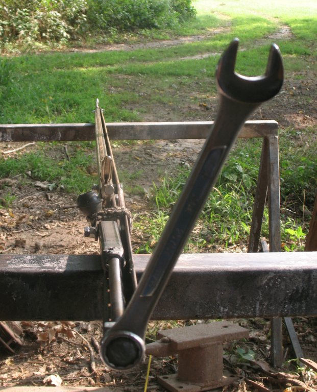

- Posts: 7393
Re: Field Coils: Must they all have even turns?
I made this to get my ribbons a straight. Locking pliers on both ends and an all thread screw to pull the ribbon tight. It stretches the ribbons so that when you rewind them you have a little extra sticking out on the end.
ryanf1023
Topic author - Posts: 124
- First Name: Ryan
- Last Name: Fenrich
- * REQUIRED* Type and Year of Model Ts owned: Speedster Project
- Location: Edmonton
Peter, I won't be wrapping them and sealing them until I know they will fit. That will REALLY make that a permanent option. I might consider rewrapping my first ring now that I know how long the lead should be.
However, I start the wrapping process with the desired lead already (other than the first trial one), and it's a matter of whether or not the variance in length affects it to a quarter turn or not.
