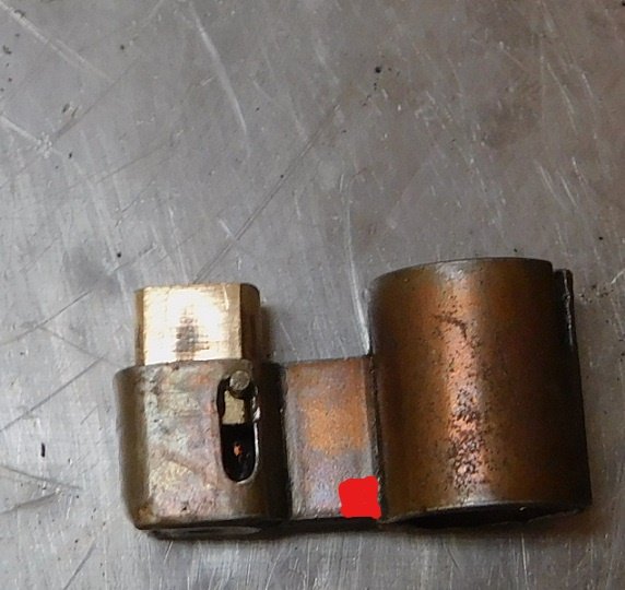

namdc3
- Posts: 402
- Joined: Sun Jan 06, 2019 4:15 pm
- First Name: Nikolaus
- Last Name: Martin
- Location: Kansas City
Re: New Day Timer Question
There have already been some good comments so I'll only add a couple thoughts not covered. If there is a fiber timing gear, you can plainly see that the cam nut extends past the shoulder on the cam (unless the gear installer trimmed the nut down). This cam shoulder is what the brush sits against. Some brushes have an OD smaller than the ID of the cam nut, so this isn't even a problem (TW, for example). An original New Day brush may need a small notch filed on the backside of the arm to clear the edge of the cam nut and allow proper seating of the brush against the cam shoulder. I've attached a photo showing where to put the notch in red (I believe the original un-doctored photo is Steve's). For re-assurance, you can measure the compressed height of the brush from the timing cover face and compare to the timer, but this is easiest done with the radiator removed.

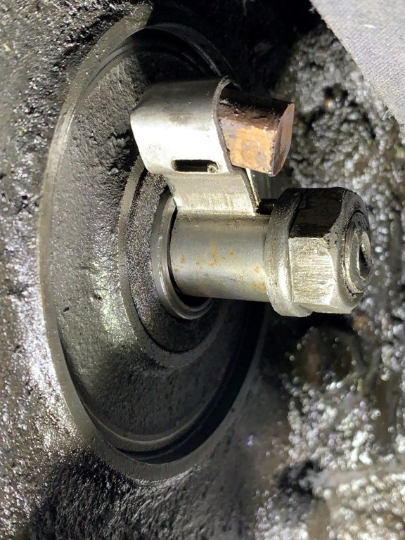

Scott C.
Topic author - Posts: 863
- Last Name: Clements
- Location: Waynetown Indiana
You guys are 100% correct! As you can see in the picture, the brush assembly needed to be notched to clear the cam nut and that it does still have the felt seal with out the shield. I had another brush assembly that was already notched, so I swapped them. I tried to install an aftermarket shield, but it did not fit right. The brush assembly compressed and distorted it. The timing gear cover may not be centered properly, or the shield is not the correct diameter? I think that I should probably install seal?

Scott C.
The timer is nice and stable now with the notched brush assembly.
Yes, the brass shield was contacting the cam nut. I could probably enlarge the center hole and install it. But, I am leaning towards installing a modern lip seal.

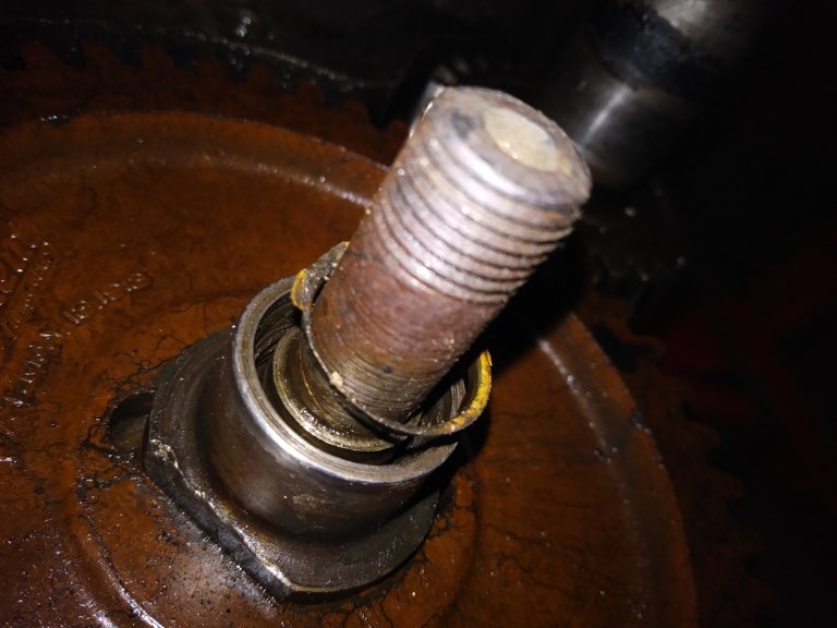

tommyleea
- Posts: 151
- Joined: Thu Sep 24, 2020 3:11 pm
- First Name: Tommy
- Last Name: Russell
- Location: Missouri
Does the seal normally ride on the camshaft nut shoulder, or on the shaft that goes through it? Is the seals purpose to seal out the oil that is in the timing cover area? Thanks for clarification for me. TommyMark Gregush wrote: ↑Tue Feb 02, 2021 11:20 amVery little if any oil would get past the threaded part where the cam gear retaining nut screws onto the cam shaft. The seal in the front cover rides on the cam nut which needs to be smooth (like any sealing surface no pits or grooves). There would be enough room along the surface of that nut for the seal in the front cover to ride on anywhere along it's length. How far out the nut sticks past were, in this case, the new day timer brush assembly needs to seat has nothing to do with sealing. My suggestion would be to get one of the shorter cam gear nuts. The cam gear shown does look a little thicker and the nut may be extending more then it needs to past where the brush assemble needs to seat.
