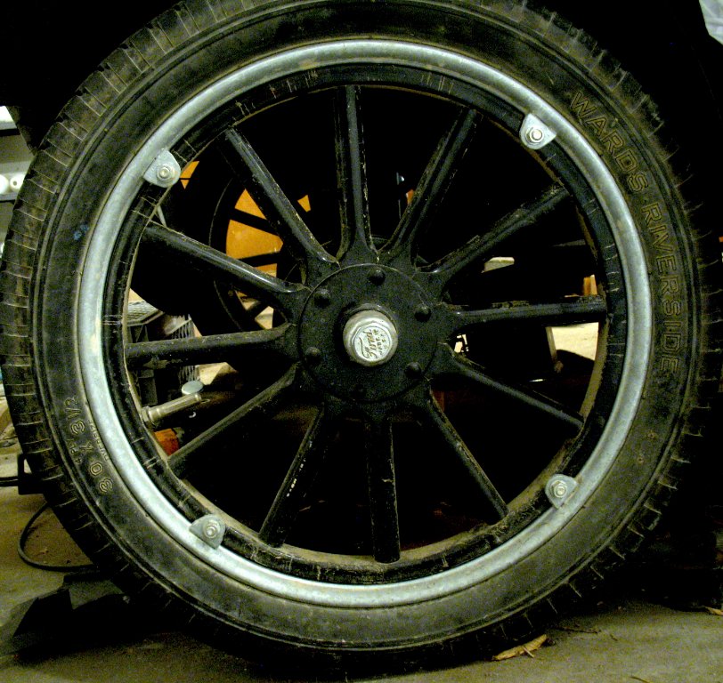

Look up Oshkosh Plating, I had these done in 2018, pretty sure it was $160 or so, and they were done in a week. I sandblasted them with a fine sand and the turned out great

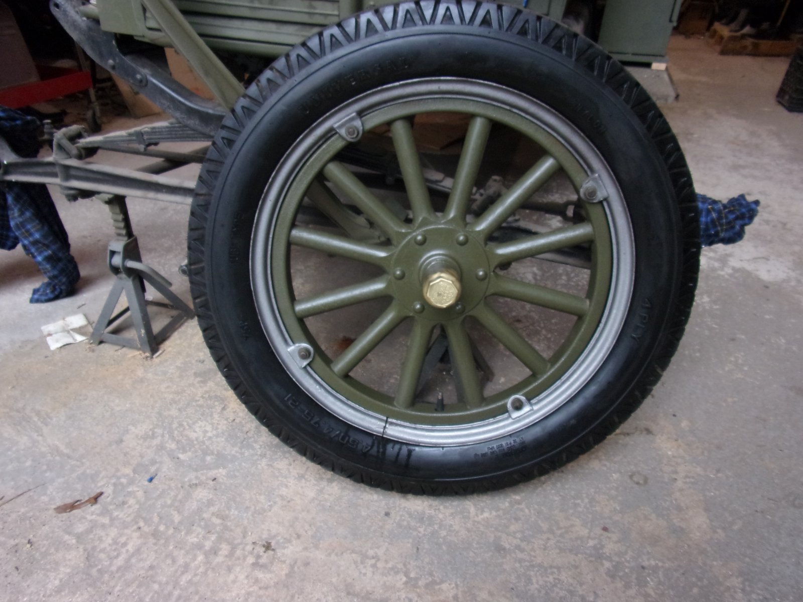

[image][/image]Sherwin Williams has a very durable silver reflective roof paint called Silver Brite that, to me looks much more silver than galvanized, which, in a short time, becomes a dull grey. Silver Brite is very reflective and is very much like the original Model T plating, which I once read was cadmium plating and not galvanized and Silver Brite is very tough, will not come off or dull. Jim Patrick

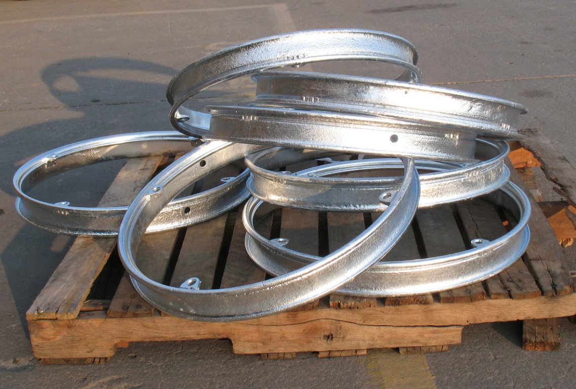

In 2012 I had seven rims hot dip galvanized at the Valmont galvanizing plant in Claremore, near Tulsa, for the minimum charge at that time of about $235. If I'd had more rims I could have had up to sixty of them done for the same minimum. Not too long ago Ignacio got a bunch of guys to pool their rims and have a lot done in a batch for a lower cost per rim. Maybe he will comment here about how that worked out.
There are several Valmont plants in the Midwest. You can Google them.
Yes, galvanizing does lose its fresh brilliant luster over time. This is last August, eight years after plating. I think it still looks pretty good.

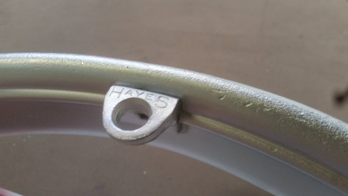

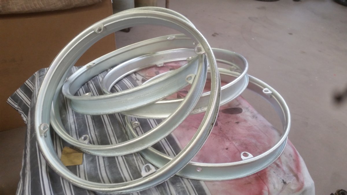

Billy's rims look to be electro plated zinc, which I believe is the process originally used by Ford. Hot dip galvanising will last longer, but does leave a little rougher finish, and perhaps a few 'dribbles' which may need dressing own before tyres are fitted. Galvanising is used to describe both processes by some, but they are hardly equal. Hot dipping in molten zinc is a longer lasting finish. Electro plating gives a smoother, more even finish, at a more competitive price for smaller lots.
I have had occasion to freshen up electro plated zinc rims, and a brush on aluminised enamel called Silva frost does the job nicely. It does need constant stirring during application, looks duller at the time of application, but dries to a nice even finish.

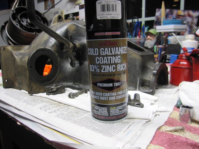

a great topic and on my spring to-do list. the pictured rattle can premium 7007 from Crown is what I might use, any input would be great.
