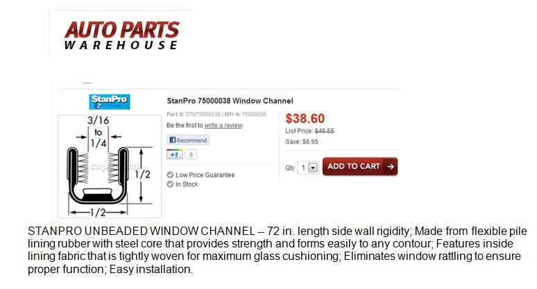

Re: Door window channel replacemant kits
I had fits replacing the window channels on my 27 Tudor several years ago using the vendor kits. The kits include a foam strip for the top. My car had the same channel as the sides on the top. The car was originally restored in the early 70's. The safety glass used was just too thick to slide easily in the supplied channel. So, did some Google searches and found a company, Stanpro, that makes all kinds of window channel. It was listed by dimension. I found some that was the same as the existing. I had to add my old clips. It worked perfectly, both sides and top.
