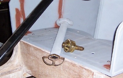

shorten steering gear 50 - Copy.jpg (70.52 KiB) Viewed 2798 times

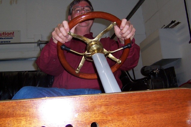

Went through two of those expensive repo brass cast quandants as miss-drilled the holes. Polished later case, repop brass cover, painted throttle and spark rods, cut short for Baklite knobs, fancy repro brass spider and wood rim

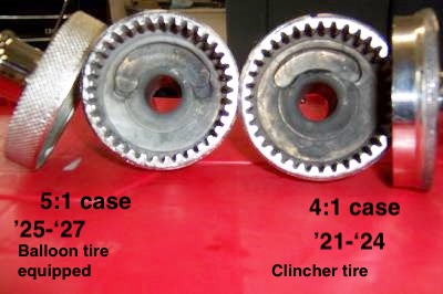

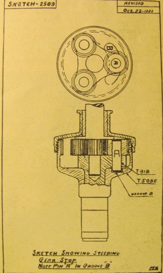

For stripping nickel plate off the steering gear case, there is mechanical or chemical means. Soaking in Caswell nickel stripper (google 'caswell plating', search nickel stripping powder) or muriatic acid. Acid leaves a red brown surface that has to be removed. Or glass bead surface and finish with fine grit paper, 1000, 1500. Then both methods need polishing on high speed buffer soft wheel with a hard bar of polishing compound.
These methods need the part to be removed for reaching surfaces, so the quadrant rivets are drilled out, and the steering case and throttle and spark rods removed from the column tube. On mine, the steering case finish was about worn off nickel, a trip to the buffing wheel and got it done, using white rouge and red rouge.

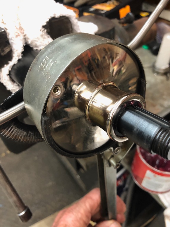

As for determining the date of your steering gear cluster case, remove the top cover by backing out the tiny single slot locking screw on the edge face, and twist off the threaded cover. A padded oil filter wrench is a handy twist off tool for stuck covers. The covers are steel, plated, and the steel cover and brass case sometimes weld their threads together :(
Then look at the case after clearing out the grease and removing the triple gears in the cluster, and note the groove in the base of the steering case. Later cases with the 5:1 triple gears have a longer groove. The 4:1 have the shorter groove. No groove means the case is pre '21 and doesn't have the improved safety that Ford added. Important....4:1 - 5:1 gears, along with 4:1 - 5:1 steering posts (shafts) cannot interchange with each other!
late and early case with groove .jpg (43.83 KiB) Viewed 2659 times
Oil filter wrench as tool.
