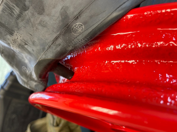

I have 5 tubes from Snyder's that are in plastic and not marked as country of origin or manufacturer. The base of the valve stem measures 5/8".

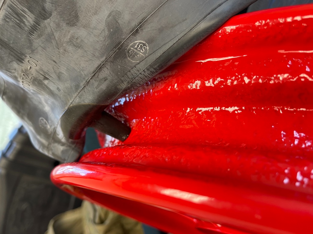

So, rubber stem will not seat fully into 1/2" hole in rims. They seat only so far and if you force any further they air up and you cannot get them back out without almost destroying the tube. What are you all doing besides running metal stem tubes? Or, better yet, what am I doing wrong?

I doubt you're doing anything wrong. I think it's more of a "re-pop" issue than anything.
If it were me, I'd just make the hole bigger, be sure to smooth the edges thoroughly. I've had the
same issue with my non-demountables, and judicial "surgery" caused the cure!

Consider drilling the rim/wheel hole larger to accommodate OR get metal stem tubes. I drilled out 21" split rims for those larger r.s. tubes - not the "proper" fix but !

Yes, I am good with the surgery. This is a driver and I will fit the stems. Seems like all the repops are the same size.

I drilled mine out - 3000+ miles without trouble.

I took a razor blade to the stems and slowly removed a lot of that extra rubber. Holding up so far.

The new tubes that I bought from Summit with my new Firestone tires also have the larger stems. So, I had my new rims made with 5/8" stem holes.
