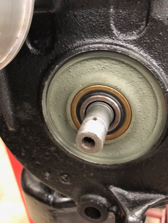

With modern neoprene seal, no brass shield is needed, there is no felt to protect.

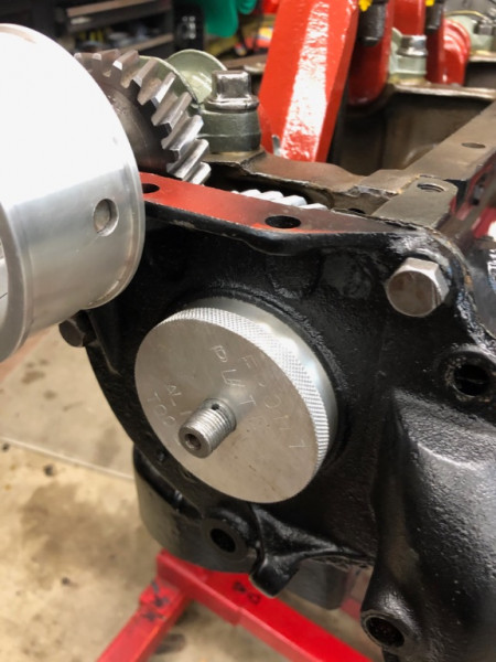

Yes, you can place seal in plate first and then center the front plate , or add seal later to cam shaft.

I used the new seal. I put the timing cover on first with the bolts loose, then the seal, then used the alignment tool. Once it was all lined up I tightened the bolts and then added a bit of Permatex between the seal and the cover. Let it sit overnight and that's it. Make sure you check the alignment one more time once everything sets up. Glad I read this I didn't know you didn't need the big thin washer.

Thanks..Pictures help..
