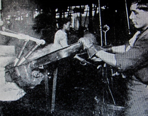

Post by DanTreace » Tue Jan 26, 2021 11:15 am
John
This is how Ford did the pan brazing in 1915, of course the process must have changed over the years for higher production rates :D
