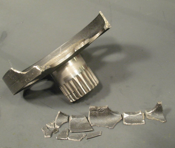

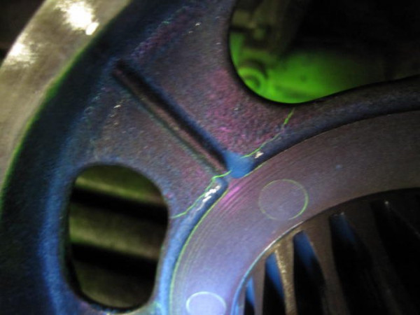

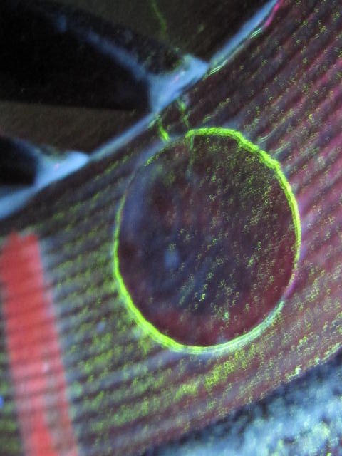

The Dye isn't as effective as the true magnetic inspection machine. I've shown a typical examples.
We are the manufacturers of the drums and gears that Snyder's sells. Our drums and gears are made to exact Ford blueprint in shape and form.
Yes they are more expensive as it is being sold as a unit not just the drum. it is all brand new. We just sold a complete set of drums to Bavaria.
Yes you would dynamically balance the "Flywheel" Starter wreath.

There are cracks to be avoided and cracks of little consequence. The J & M photos show both. The cracked web in the drum makes that drum a throw away. The small one around the rivet is of little consequence. It goes to the inside of the drum hub, and was most likely created in the riveting process when the gear was installed.
That said, I have removed drums from transmissions that have been in service, and have found web cracks and even drum wear surface cracks successfully bronzed and put back into use. The new drums made available mean we do not have to resort to these means and I am thankful for that.

The crack in the rivet hole would lead to the drum failure as every time the pedal is applied the drum is loaded.
In this instance the drum would come loose and end up broken, basically any crack on a load bearing part is not recommended to be reused.
Since we are in business; we can't put bad parts in that would jeopardize the engine or customer.

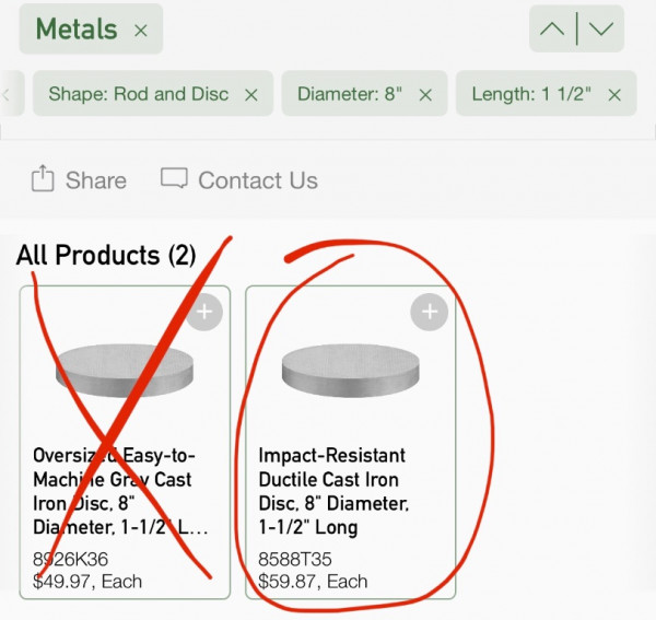

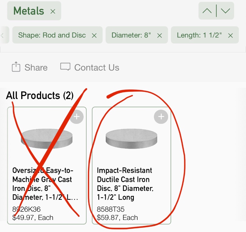

Just as an aside, Here is a little food for thought for everyone who has a lathe, mill, rotary table, and some time to kill: The disc of ductile iron required to make your own low or reverse drum is $60 from McMaster... Maybe less if you shop around...
