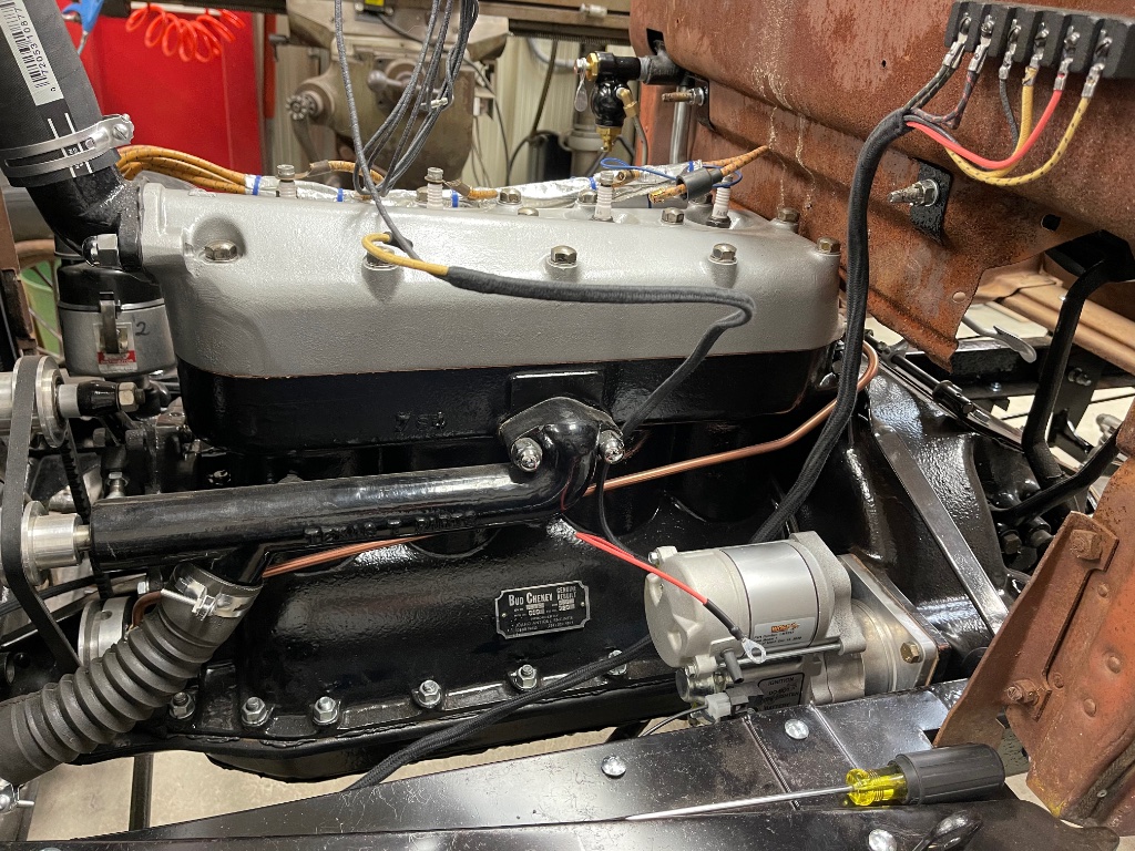

Starting to pull wires on this beast and have a few questions. I have no problem landing all the wires as I have 40 years as a control electrical engineer. I am trying to find pictures of how the wires are run. This is no where near original so I am not being anal. But want to stay somewhere between the lines.
Headlight harness run down the side of block or tuck into the frame channel?

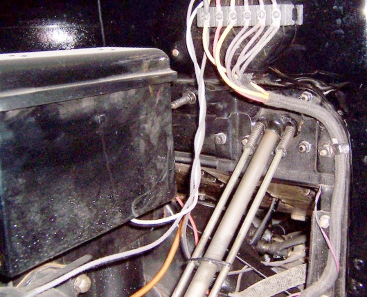

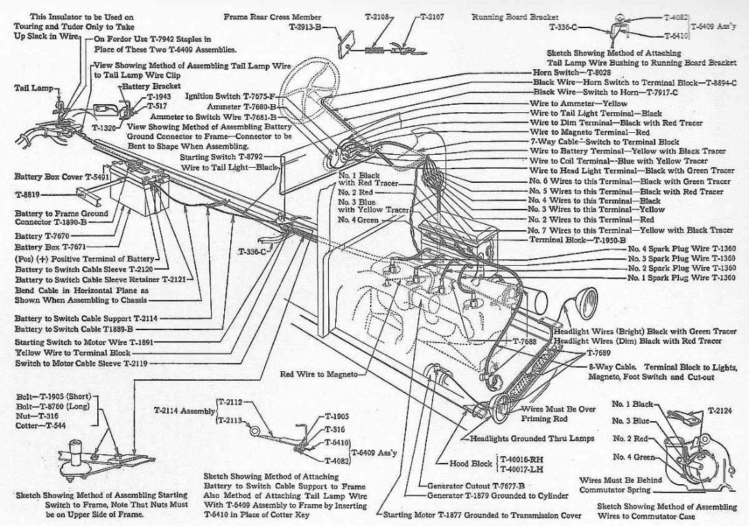

Looking for past discussions, I don't know what is correct either but....
\Next pic from http://www.mtfca.com/discus/messages/70 ... 1490240857
http://www.mtfca.com/discus/messages/59 ... 1476246267

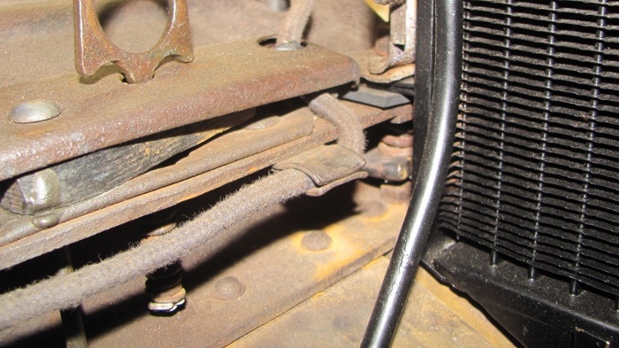

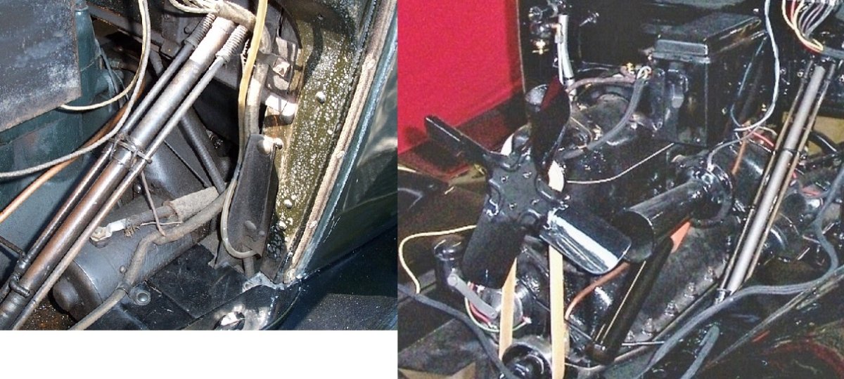

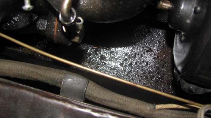

Post by DanTreace » Mon Mar 01, 2021 3:25 pm
Factory used clips on the upper frame rail, two-part clip. Bolts and nuts hold them to holes in the frame rail, they jut out from the hood aprons.
Clips too on the fire wall.
