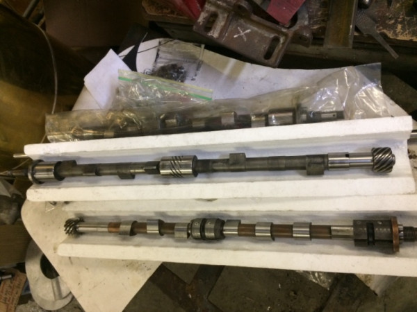

On my " C" crank in a " T " block seems like I remember we had to turn down the OD of the counter weights to clear the cam .

The counterweights are OK but I had to trim beside the throws for clearance to the camshaft. Now the A camshaft is bigger than a T camshaft and I have filed notches in the camshaft bearing bores

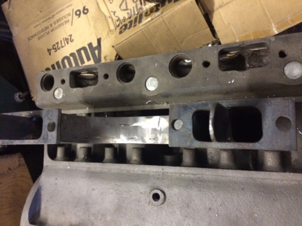

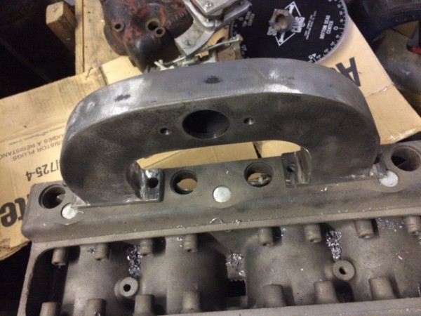

This manifold can be mounted either way up to accommodate either a updraft or downdraft
Effectively a 4 intake port manifold. Without the divider the bottom end torque is poor.

Looking Good Les!
Question about the porting, Can you do that without any welding or epoxying , my concern is water the jacket? I know that some epoxy filling can help flow in the intake ports. Thanks for sharing a wild project!!

No welding or epoxy!!

Nice work Les, how much of the manifold is plenum...? And how much is runner...?

The majority of the intake is runner. Just plenum under the carb.

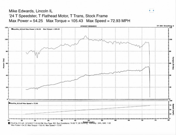

This Model T kicked my butt in Lincoln Nebraska 2017. I believe that this is his dyno sheet, WOW. It has simmilar porting.[/size]

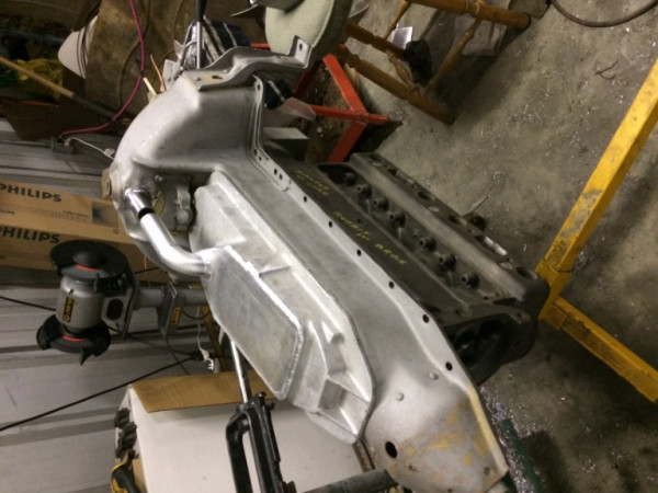

Les, did you ever do any research into wet V dry flywheel housing? Seems like a lot of drag to me, but I've never noticed anybody addressing this question. Thank you, Dave in Bellingham

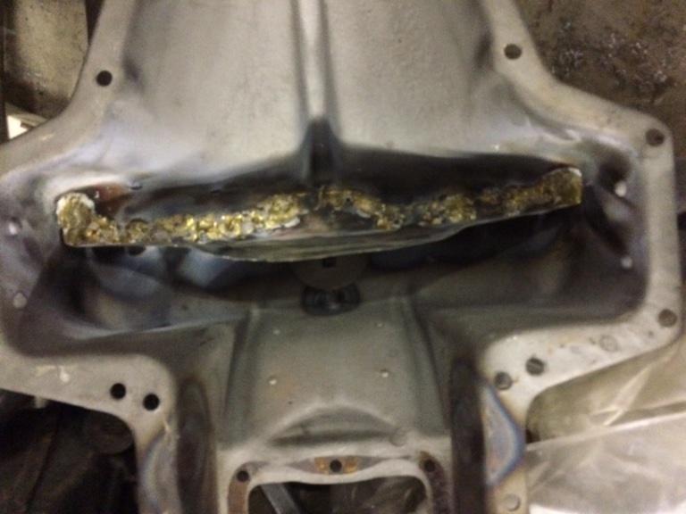

Les Schubert
Topic author - Posts: 1364
- First Name: Les
- Last Name: Schubert
- Location: Calgary
Re: C crank T block progress!

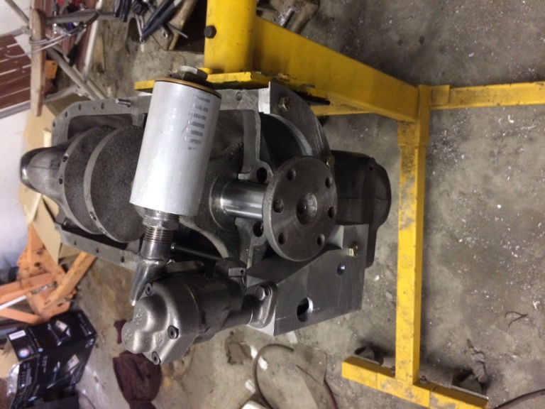

I run what I call a “semi dry” flywheel!! There is a dam that keeps the oil away from the flywheel. The transmission shaft is drilled and fed from the rear main bearing. Some oil is sprayed onto the bands.
Dave Sullivan
- Posts: 64
- Joined: Tue Jan 08, 2019 7:35 pm
- First Name: David
- Last Name: Sullivan
- * REQUIRED* Type and Year of Model Ts owned: 1923
- Location: Bellingham WA
Thank you, sir, I've been pondering this for some time, thinking of using a dry clutch. Dave in Bellingham
Les Schubert
- First Name: Les
- Location: Calgary
Dave
Well if you are planning to use a truly DRY clutch, that is a completely different thing. Assuming that you are not using the T transmission!!
Weldemup57
- Posts: 7
- Joined: Sun Mar 29, 2020 11:20 am
- First Name: Rich
- Last Name: DiVirgilio
- * REQUIRED* Type and Year of Model Ts owned: 1926 Speedster
- Location: Windsor NY
Les,
Very interested in how you set-up your semi-dry flywheel .
Any pictures or drawings?
Thanks for your time.
Les Schubert
- First Name: Les
- Location: Calgary
I hope this helps
