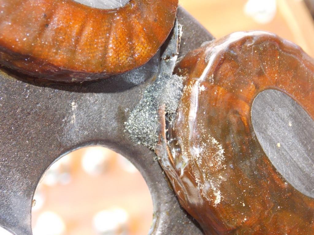

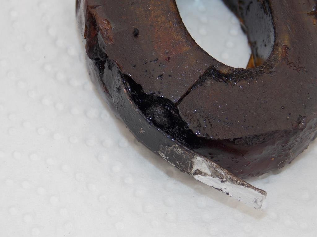

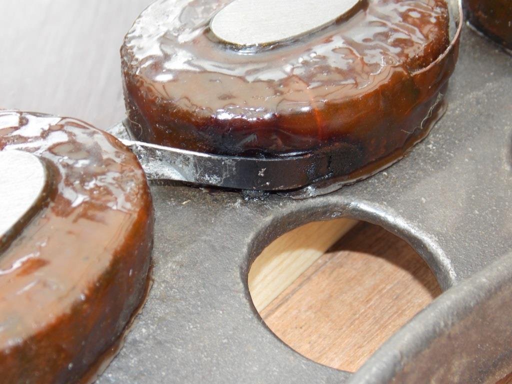

A local friend has just a few miles on his '26 Coupe and experienced 'sudden-onset' rough running on magneto the other day. The car runs much as before when on battery but very poorly on mag. Previously, switching to mag from battery perked it up as one would expect. Al says the wiring checks out OK and the car is running a new Anderson timer.

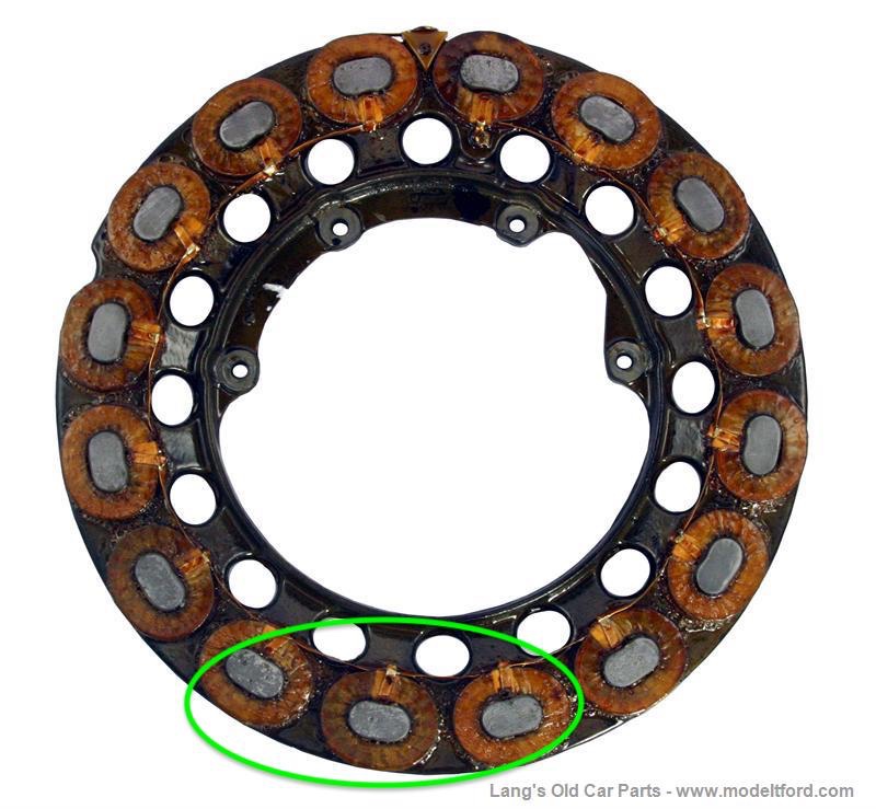

He suspects the magneto coil ring. His best coil ring when assembling the engine had three damaged coils (as below) which he replaced with coils salvaged and rewound from another ring.
If the ring has failed it will need obviously replacement. But for now and for diagnostics, our question is this: If one of those three rewound coils has shorted to ground, will the remaining six, seven or eight coils that are not shorted out result in this rough running on magneto?

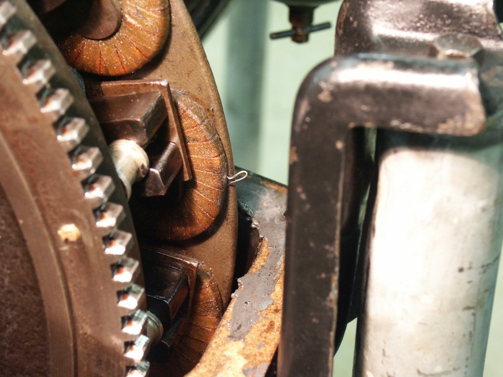

Back in 2004, I had the same problem not long after a rebuild. The rebuilder asked me to remove the hogshead and look for something suspicious. Well I found it. There was a small piece of tie-wire wedged in between one of the newly wrapped coil rings and the mag ring. And, it looks like the wire was probably up against the hogshead, too. The members of our club, The Tennessee T's, call this a "Booger in the Pan".

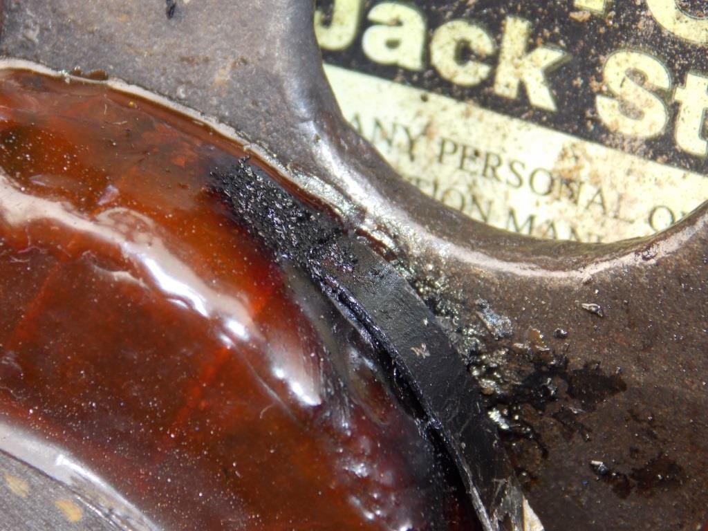

Here is an other one, freshly rebuild, stand for 200 miles and than failed.
Reason was debris and band material.
Andre
Belgium

The mag will NOT run with half the windings grounded. It won't even run with less than half of the windings grounded. It happened to my '14 about 10 minutes after its first start-up. A broken cotter pin grounded the coil at about the 7 o'clock position, reducing the 17.8 volts that I had been getting at idle down to 2 volts, not enough to fire the coils.

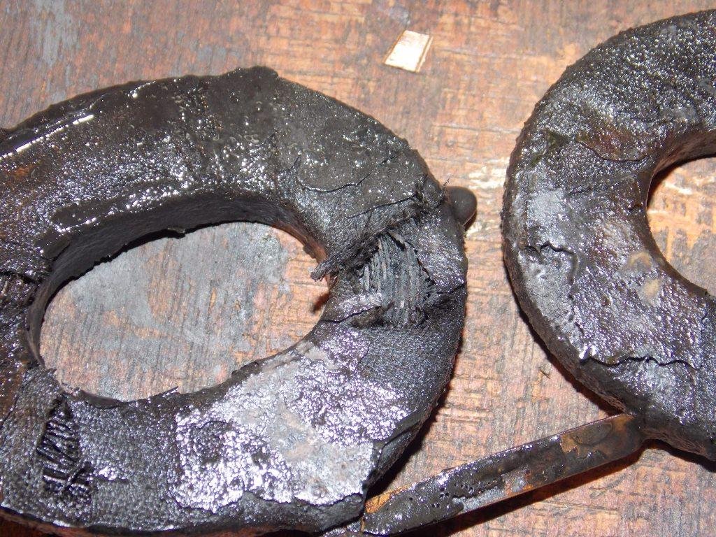

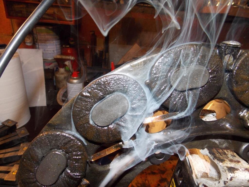

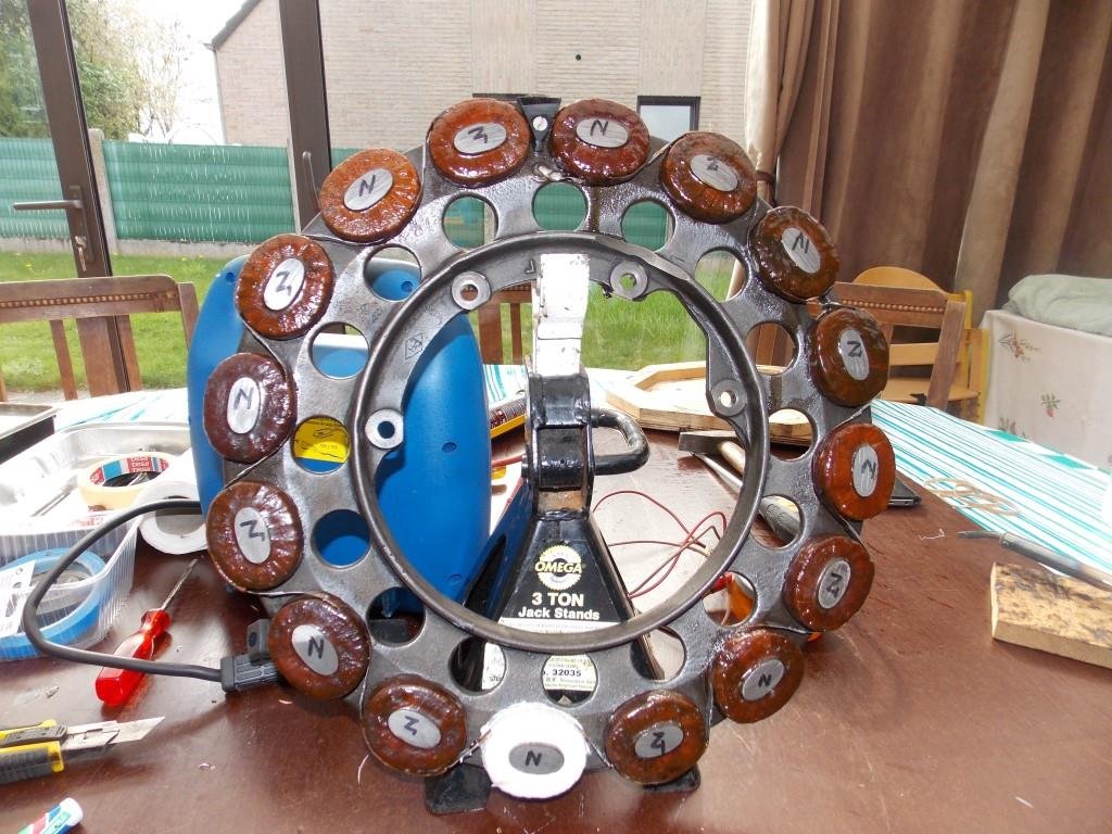

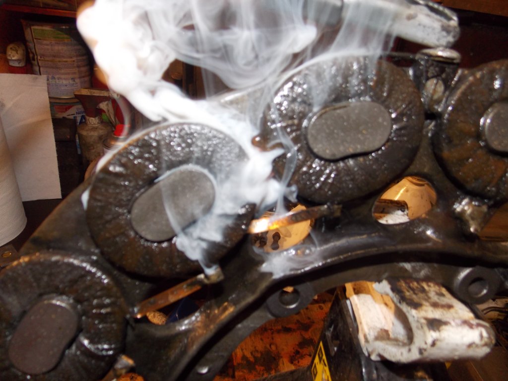

My opinion: It will not run right with a grounded coil even if there are 15 coils left to produce the tension because of the current drop in the loop.
The place where the short is, there will always be a resistant and will drop the current out put of the magneto. (Spark smoke and heat)
The coils need between 1.3 and 1.5Amp to spark right and are not only working on tension but they need current too.
On my HCCT a good coils start to spark 1/4" long at 1.8Vac and 1.3Amp. That also the reason why with a good magneto and right coils you should be able to start the engine by hand cranking, 2Vac to 3Vac but more than 1.3Amp out put.
Just my opinion.
In the attachment some other photos of schorted magneto loops.
Andre
Belgium
Just my opinion.
Andre
Belgium
