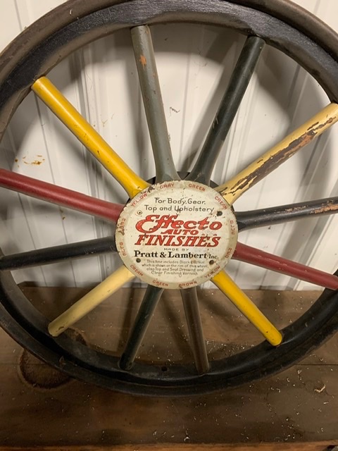

After market colors

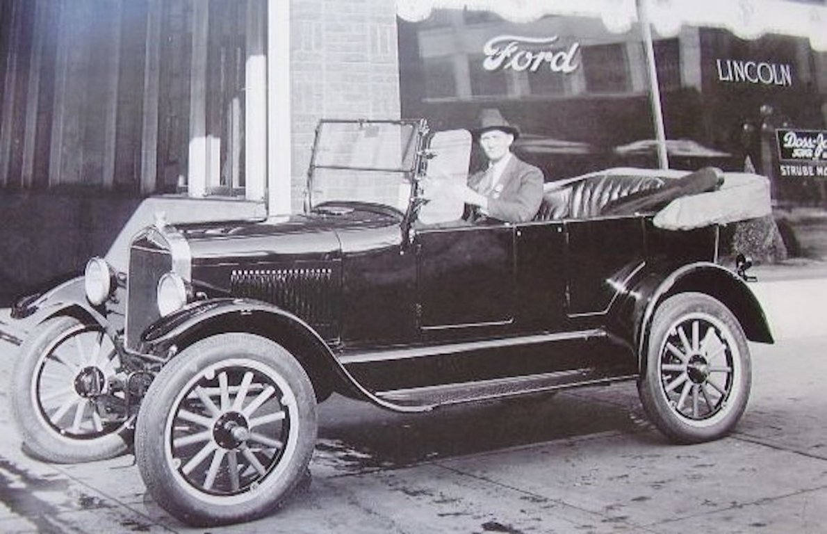

While "natural" wheels became an option in 26-27, they are primarily a modern fad. Before 1926 all wheels were painted body color (black 1913-1925). In 26-27 the stock wood wheels remained black. I believe that's what you'll see in most period photos (not advertising) of Fords with wood wheels. I believe I've seen "natural" wheels in 26-27 advertising, but even there the wheels are usually black.

Dan Haynes

Natural 21" wheels were listed in the 1925 Ford Price List of Parts, Steve.

That's a cool "advertiser" for sure, Dan !

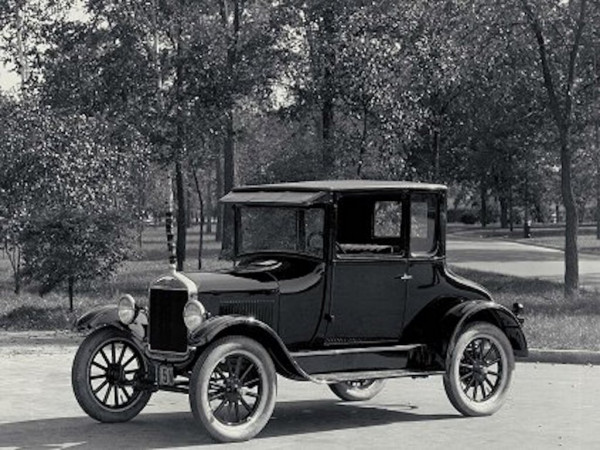

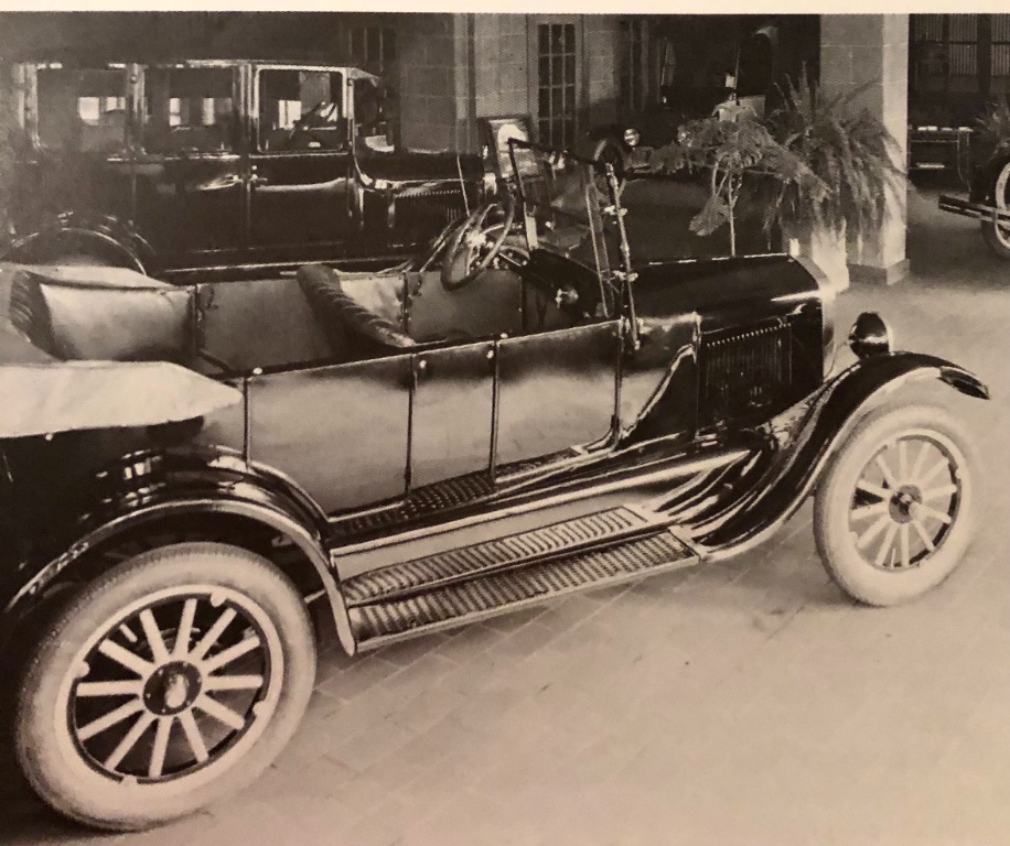

This is one of the two real-world period photos I've seen showing the 26-27 varnished wheels on a car. I wonder if anybody can find some more. Is this the new owner showing off his spiffy new Ford in front of the dealership, or a salesman?
Here's a previous discussion with the same photo.
http://www.mtfca.com/discus/messages/82 ... 1545720468

Another new Touring, sport model in 1926 in dealer showroom.
Just like today, the dealers present the most beautiful or optioned out cars to draw in customers. They know what the customer likes the best, and sell that high end model.
Many didn't go for the 'beauty' T of the day, but a lot did as marketing of features was done by all the other mfg. and in 1926 natural wood finish on spoke wheels was the In Thing.
You were driving the Cat's Meow if your new T sported tan top cover, windwings, and those beautiful varnished wood spoke wheels, that glimmered like a Gar Wood fast craft.

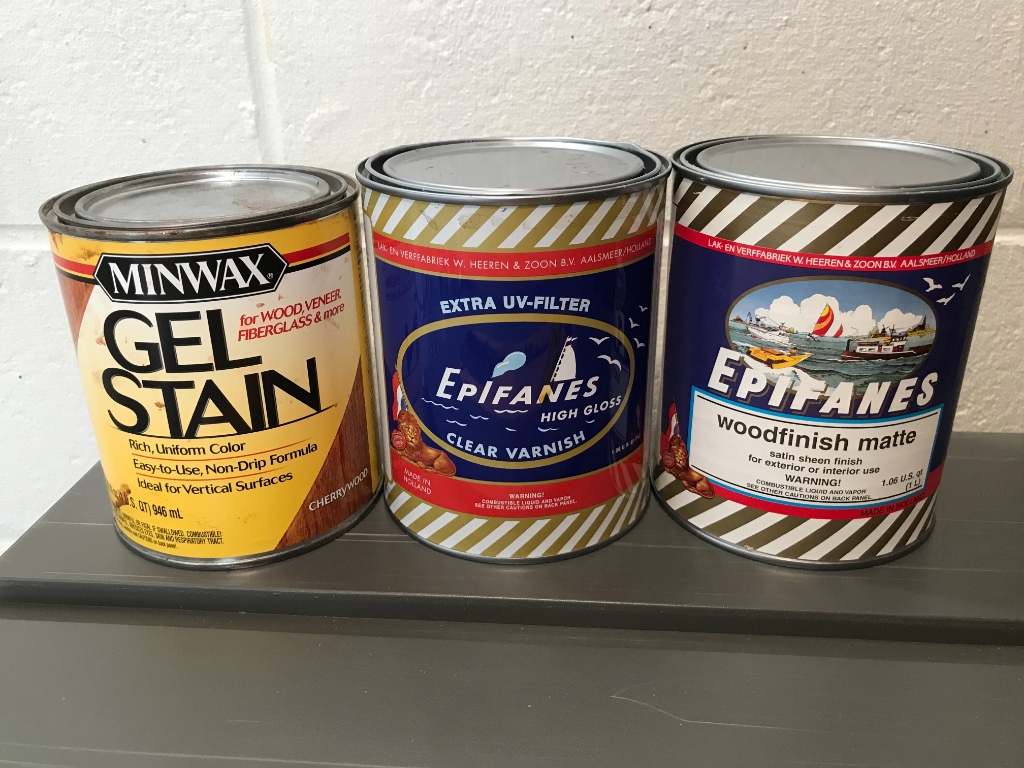

Back in the ‘50’s my grandfather stripped the paint off the wheels of our Touring and varnished them. I like to keep the car like he had it so when I had the wheels rewooded almost 10 years ago I didn’t want to paint them.
First I used Minwax Cherry Wood Gel Stain to give some color. Then I used the Epifanes Clear Varnish followed by the Epifanes Matte finish since I didn’t want a high gloss finish. Pretty sure I used a foam brush.
They have held up great and look just as good as the day I mounted them back on the car.
