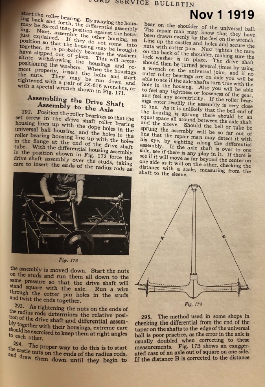

Service Bulletin 1919 discusses this issue.

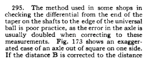

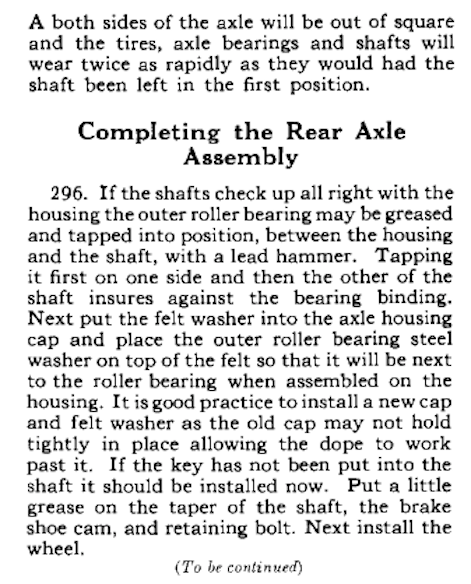

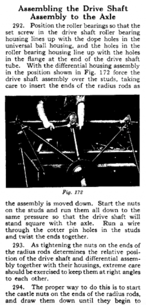

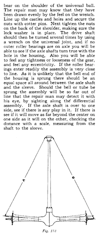

Here's the Service Bulletin article from a PDF.
Screen Shot 2021-01-29 at 10.21.18 AM.png (92.67 KiB) Viewed 4422 times
Screen Shot 2021-01-29 at 10.21.44 AM.png (236.35 KiB) Viewed 4422 times
