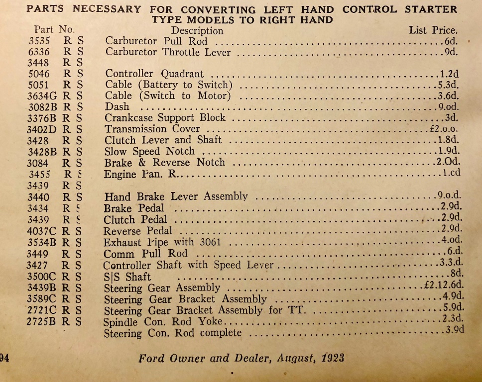

Found this chart in Ford Owner Dealer, from UK dealer on parts needed to convert left hand starter cars after 1923, to right hand drive.
- Posts: 5400
Re: RHD Parts List
I read it two times and the thing that stands out is the crankcase support block? There is no left or right on that one that I have seen. Other wise I think we got it all. Thanks for that list.
- Posts: 1454
- Last Name: van Ekeren
Re: RHD Parts List
Maybe the fuel line needs a little tweaking at the wood block to clear the exhaust pipe taking a new route.
