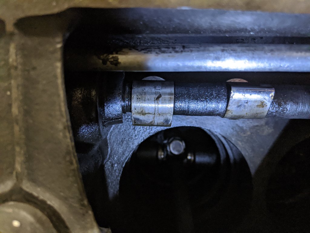

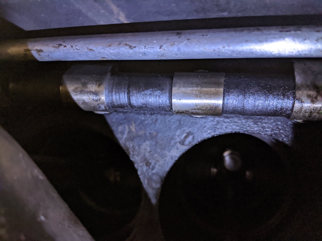

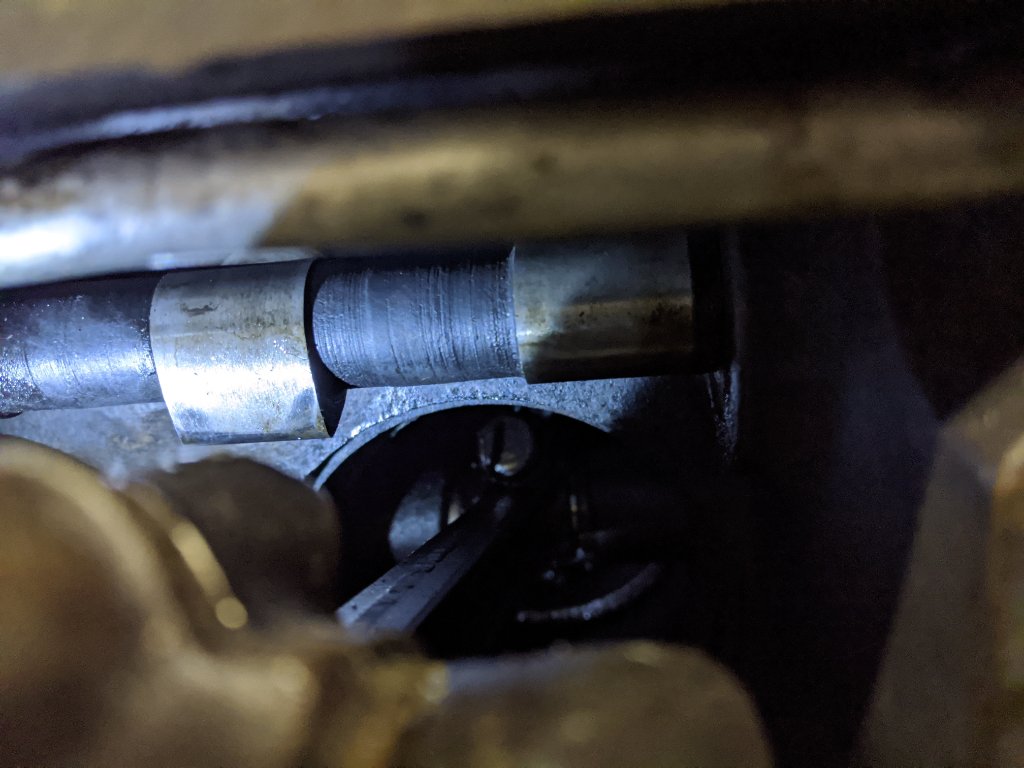

Re: How to tell if I have a reground cam?
My gut feeling says, no has not been reground.
From looking at your pictures, it is unlikely that it is re-ground.
If it has been re-ground, then odds are very good that it was done to a high quality standard, but you are very unlikely to find one of those in an unknown, used motor.
Most re-ground cams are not done to a very high quality standard. You can generally spot one of those because the heel of the cam is actually ground into the shaft area of the cam.
