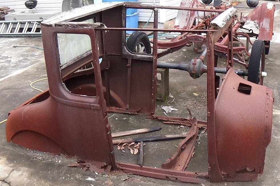

BLB27 wrote:
Sun Jan 31, 2021 1:51 pm
The floor of the body is the only structural element resisting distortion during handling.
The floor was not holding our T together, as it was rusted through. The top piece which you have not found yet will hold it together.
Vern (Vieux Carre)
