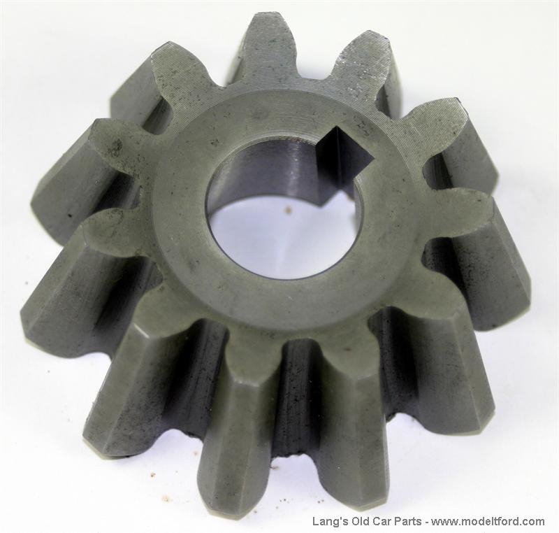

If anyone would happen to have a pinion gear close at hand, I am looking for a couple of dimensions/measurements. Basically I am looking for the overall width/diameter of the gear (widest point) and the overall height of the gear. There is a 300+ mile difference between myself and certain spare parts and this is one of them and I need these dimensions for a project that I am working on for the Spring. Thank you for your time and help, it is appreciated.

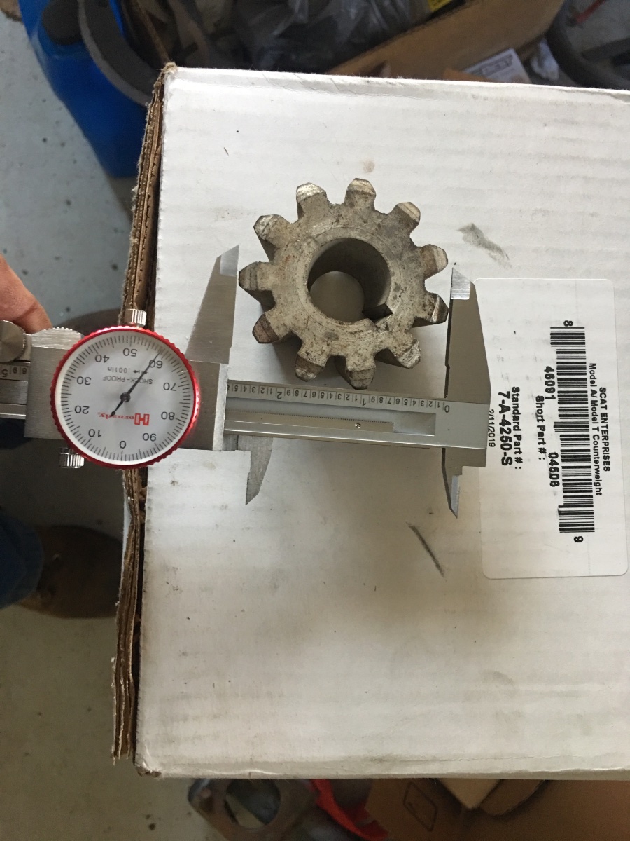

11 tooth 2.558.
1.100 y’all
Hi speed pinion larger in diameter
1.100 y’all

Thank you Randall, exactly what I needed.
