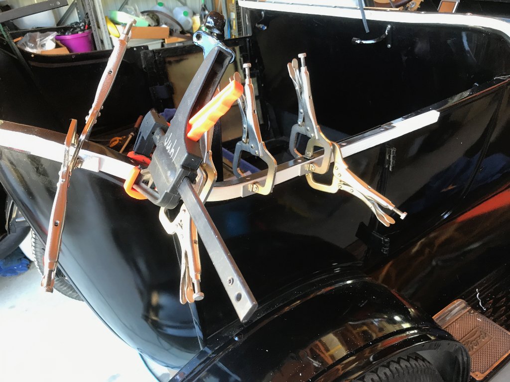

Re: Wood tack strip
I started trying to fit wood trim strips from a respected supplier but the fit was such that I would have had to do a fair amount of steaming to get them to conform. I ended up doing as Dallas and making my own from composite strips I bought at Lowe's. I bought trim strips of the correct thickness and then cut them to size on a table saw. Using a heat gun and clamps, they went on super easy and are holding tacks well.
One caveat - when you heat the composite material it will soften somewhat so I cut some pieces of aluminum angle to distribute the pressure from the clamps so as to not make dents. It only takes a couple of minutes to harden to shape. I was able to do a whole seat with a single piece. I started in the middle and did one side and then the other, trimming the ends when I was done. After fitting, I removed the strips and painted them with rustoleum black (they were originally white.)
