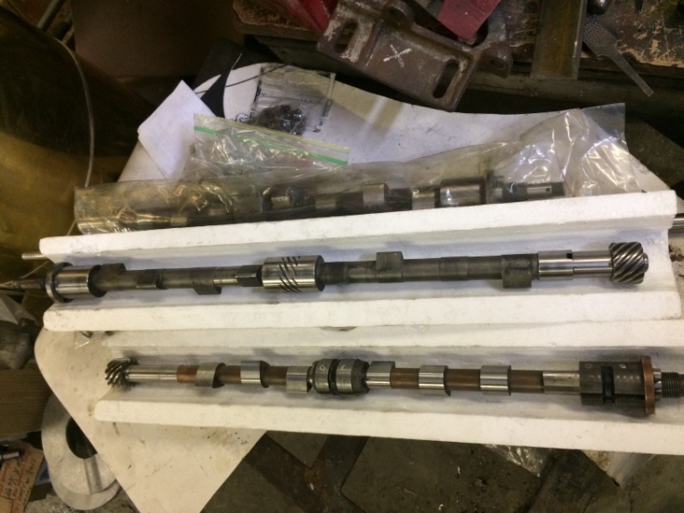

Race grind A cam modified to fit T block

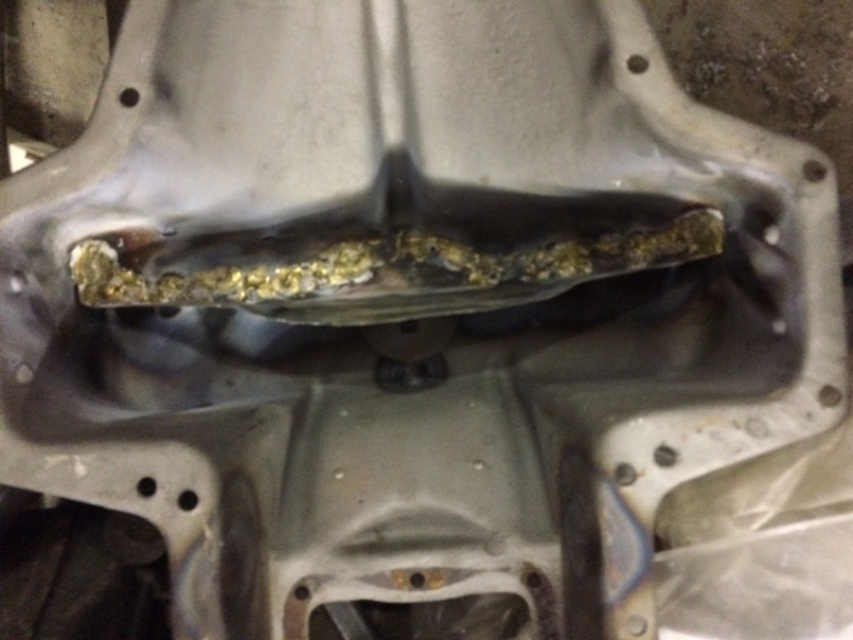

Stretched pan (shortened nose). Sump mod

The counterweights are OK but I had to trim beside the throws for clearance to the camshaft. Now the A camshaft is bigger than a T camshaft and I have filed notches in the camshaft bearing bores

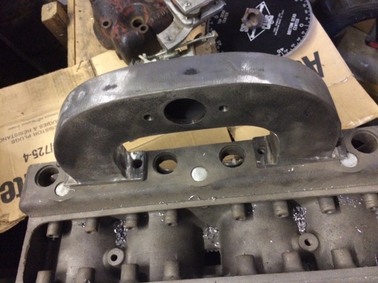

This manifold can be mounted either way up to accommodate either a updraft or downdraft
Effectively a 4 intake port manifold. Without the divider the bottom end torque is poor.

Nice work Les, how much of the manifold is plenum...? And how much is runner...?

The majority of the intake is runner. Just plenum under the carb.

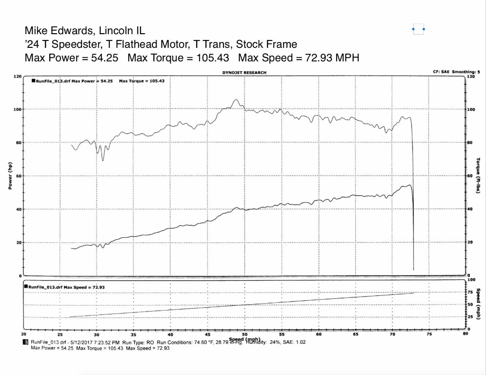

This Model T kicked my butt in Lincoln Nebraska 2017. I believe that this is his dyno sheet, WOW. It has simmilar porting.
[/size]
