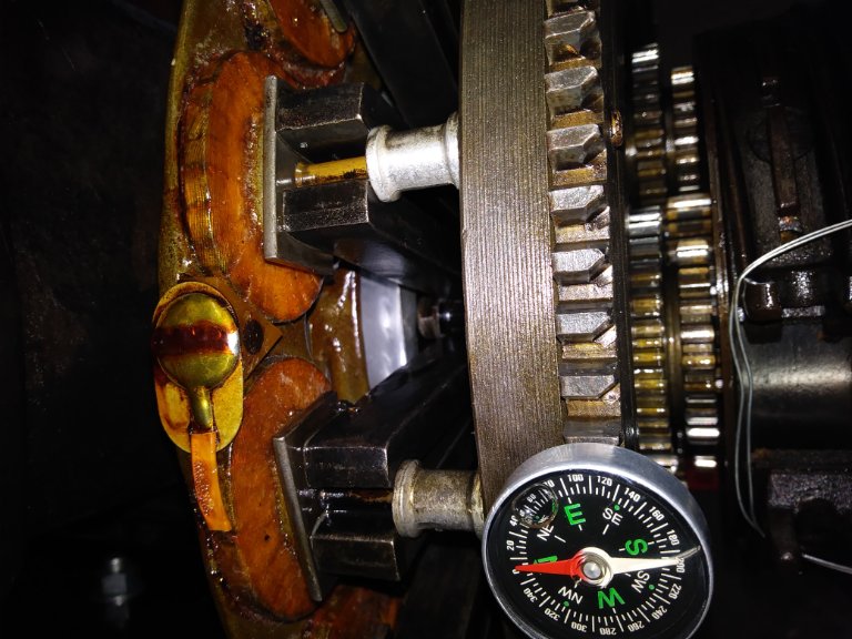

Here is a picture of the orientation with the use of the compass.
jiminbartow
- Posts: 2489
- Last Name: Patrick
- Location: Bartow, FL
Re: Recharge
Make sure your car or engine is not oriented with the front to the north. If it is, orient it so that the front is oriented to the east, or the west. That way, when the compass points to the north, you can be sure that it is not pointing to the earth’s magnetic north. Jim Patrick

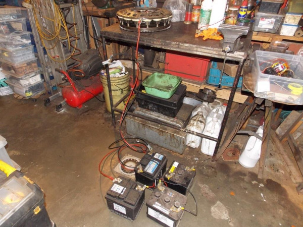

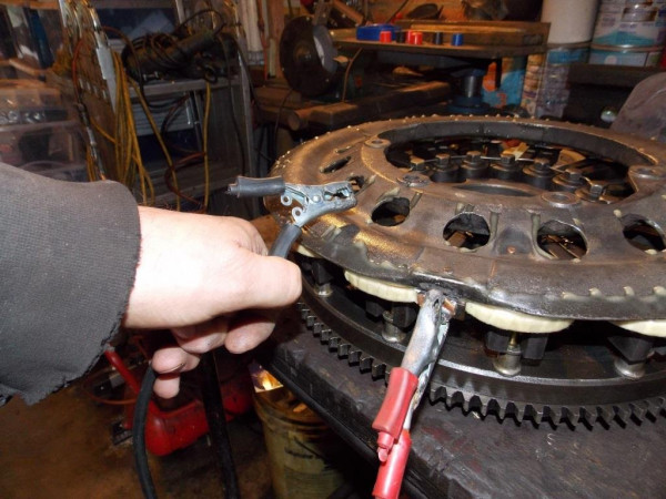

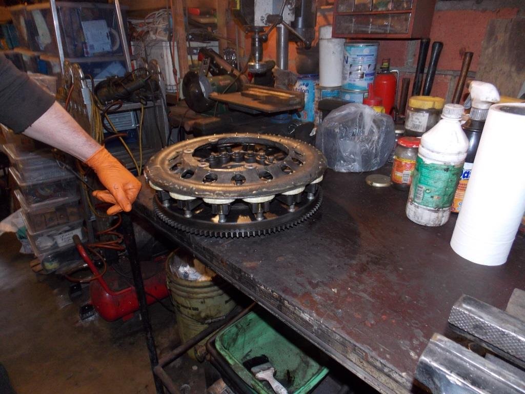

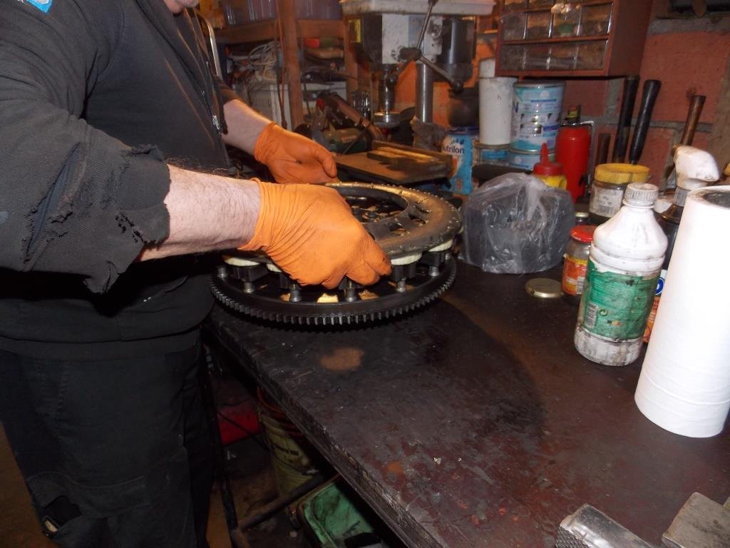

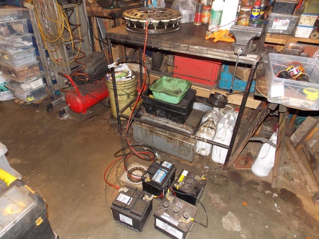

There is a fourth way to charge the magnets, an easy one when it is all apart, with a fresh rebuild flywheel and good magneto coil loop.
Put the flywheel with the magnets on top on a flat table. Put your coil ring, well centered, on top of the flywheel North magnet on South coil.
Connect three 12V batteries to get 36V. Connect the positive wire on the magneto post and flash a, few times, with the negative wire on the coil ring frame.
I leave the negative wire connected for 2 seconds each flash, 5 flashes should do the job.
Test for the charge: Try to seperate the coil ring from the flywheel by hand, you will need a bar to do that.
Most of the time you can lift up the magneto ring with the flywheel hanging on it.
Twelve years ago I did this also with one 12V and one 6 V battery (all the batteries I had available that time), the car is still running well on magneto.
The flashing is also a good test on the condition of your coil ring.
Good luck
