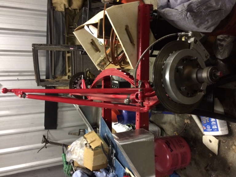

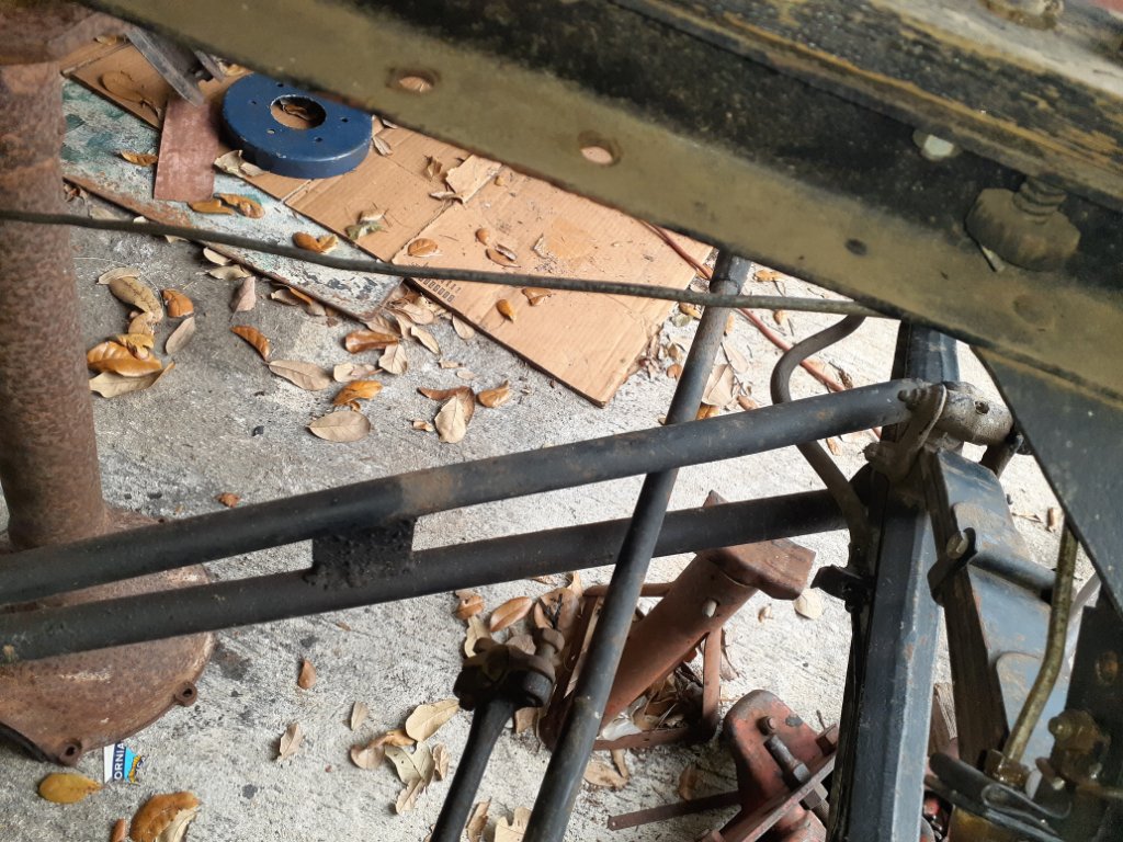

If you put any brakes on the front wheels, be sure to beef up the suspension. The T is prone to losing castor by just bumping the front wheels too hard on a pothole or curb. Even the Model A had front brakes which just slowed down the wheels, but the back ones locked them up. Anyway it would be especially bad on a car with the radius rod bolted above the axle, but even on one with the rod bolted under the axle, it could cause a problem. If it happens, your car could suddenly veer to one side and pull the steering wheel right out of your hands. So be sure to add additional support.

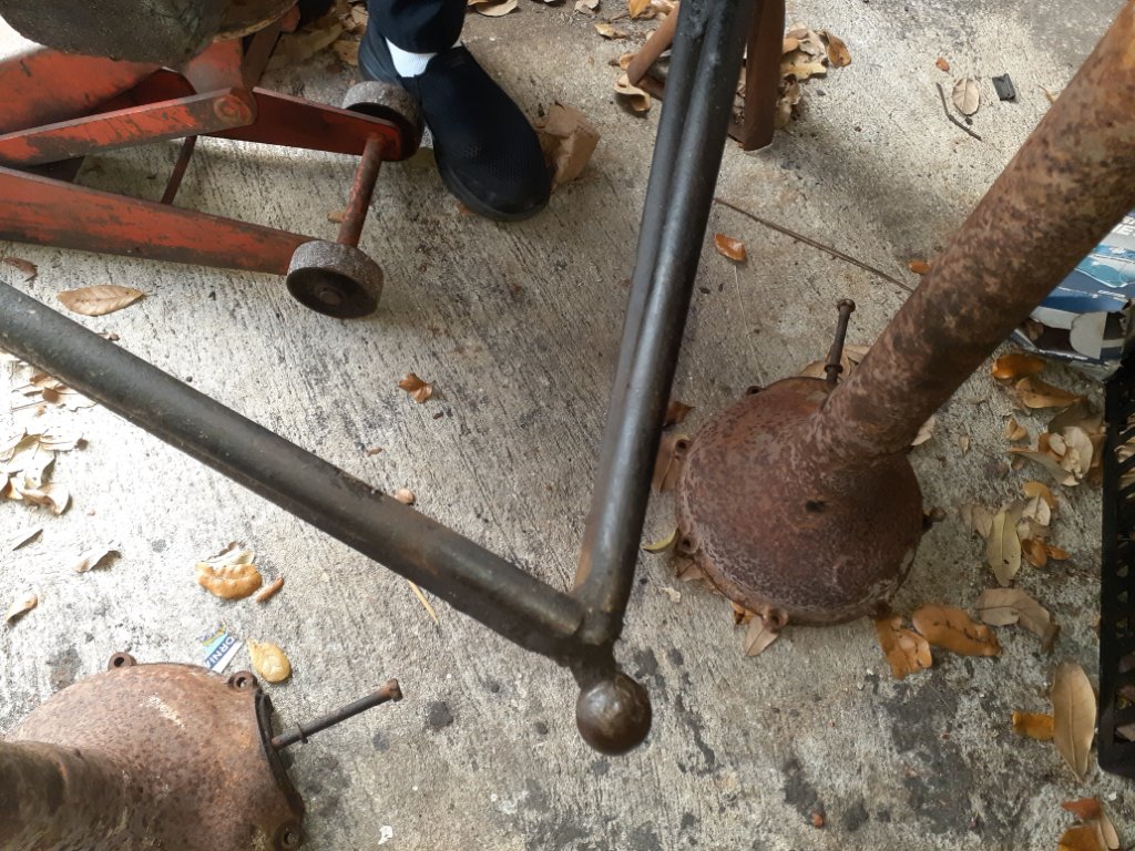

Is it worth it? I mean I’m assuming you have them in the rear and can lock the wheels with them. Think about going in reverse and tearing the radius rod ball joint out & folding the axle over.

I would also have worries about front brakes on a Model T, even with additional radius rods.
The rear brakes are self-limiting in terms of the loads going through the wheels and suspension. The harder you brake, the more weight is transferred from rear to front, and the wheels lock at low 'g'. Probably no more than 0.3g. But for a 2000lb car, that's still 600lb feeding down to the transmission ball joint.
Front brakes have the opposite effect. The harder the braking, the more weight goes onto the front wheels and so the force at which the wheels lock is much greater. Modern cars reach about 1g, and most of the braking effort comes from the front. If you fitted very powerful brakes to the front of a Model T, you might well achieve up to 0.8g (limited by the tyres), but the high cg would mean lots of weight transfer. A 2000lb car at 0.8g with most of the braking on the front would have to take about 750lb rearwards and maybe 650lb vertical load on each front wheel and spindle. That's 1000lb total.
More worryingly, the 1500 lb of braking would go right into the radius rod ball joint on that tin sump.
A Model A expert told me once that Model A front brakes were deliberately weak and only contributed about 40% of the braking. That's despite the Model A having very substantial front suspension.
It's very tempting to try to do better than the 0.3g available (at best) from any type of rear wheel brakes, but I would worry about having front brakes which pushed that beyond about 0.5g

On any thread about Front brakes on a there's always lots of comments about how the front axle will fold under or how the thin sheet metal pan will get bent.. There are a few of us that have T's with brakes on all four wheels. Ralph Ricks RIP aka RDR probably drove more miles with his T with front and rear brakes made from Metro hydraulics. He did two Great Races when his car was in the Speedster configuration and later converted it to a Picup as a daily driver hauling loads from Home Depot. We've done some panic stops for testing without any issues. On my '12 with the McNearney / Big Four front and Bennett rears I have not seen any distortion of the early pan. Last time I had the pan off the alignment was perfect at the fourth main.
I feel anyone who drives his early T a lot should have a double wishbone installed for safety! Of course adding brakes its a no brainer.
