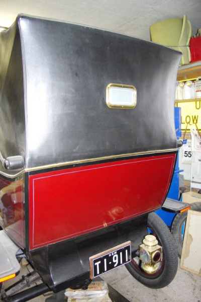

Just checked photo's of a 1910 RHD with known history here in Australia, shows it had a left side mounted tail light.

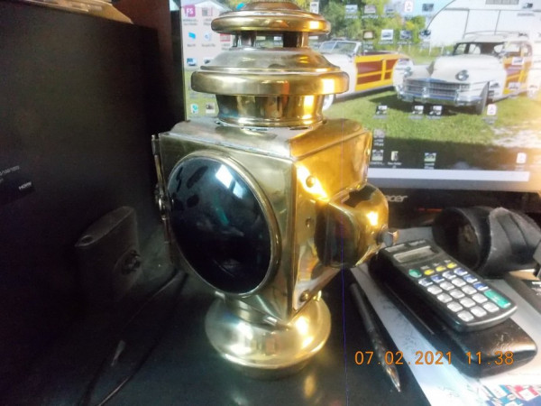

If the correct orientation of the lenses is red to the rear, clear to the left and blue to the right, on RHD cars, I believe any of the lights can be tailored to suit. The lenses have a rolled on brass rim. Rather than change the lenses from one side to another, it is easier to dis-assemble the light body and reassemble the body up-side-down, so that the clear and blue lenses are swapped form side to side. On my 1912 van I mounted the tail light on the right, but chose to leave the light I purchased in Spokane in 1989 with the lenses as per LHD, clear to the outside of the car and blue to the centre. It doesn't illuminate the number plate anyway, so the clear to the outside is of no consequence.

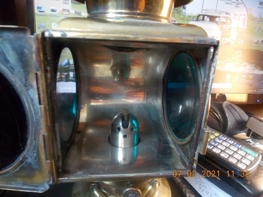

The lens exchange is very simple if you have an original lamp I opened the flap of the lens on the inside about half way around, it is not soldered this makes it loose and easy to remove. Went back in the same way ,use smooth pliers to flatten the lip and it was again solid with no movement of the lens.
