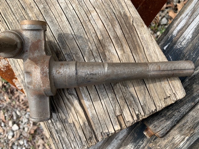

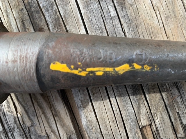

Re: Rajo self steering spindles
Post by Dan Hatch » Sun Feb 07, 2021 7:14 pm
The reason I asked if they were marked is I have only seen one set marked Rajo of the 12 sets I have had. Dan
Posts: 5543
Last Name: Hatch
Location: Alabama
Post by Dan Hatch » Sun Feb 07, 2021 7:17 pm
Here they are
