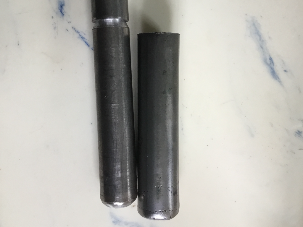

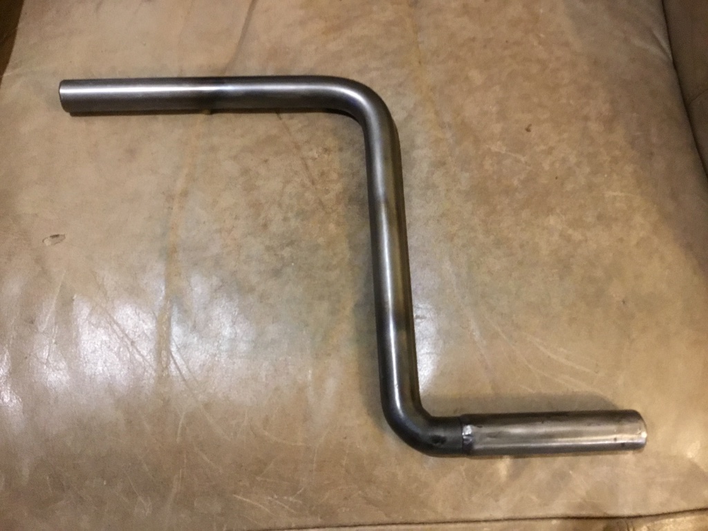

Anyone building cranks? If so what are you using for the sleeve? The only thing I’ve come up with cutting down some non-galvanized tubing, any ideas? The crank is 3/4 cold roll. Bob at 9othree 824 194nine.

. The sleeve crimps over a notch in the crank. And it’s not hard to split the tube, close it and tig it back. I’m was just hoping to find a tube stock the proper size. If you have a frozen sleeve on an otherwise good crank you can use a small hammer and tap the sleeve all around until it frees.
