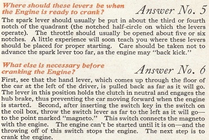

Perhaps it is because Steve Coniff and I spent so much time years ago investigating and writing articles about the much misunderstood "Model T Ford Ignition System and Spark Timing" was designed and actually worked that I harp on you understanding this subject getting this correct. Frankly, we both got weary of verbally explaining how it was intended to work, so we wrote this article: http://www.funprojects.com/pdf/Model%20 ... iticle.pdf
It may take some time to fully understand, but if you do it will become clear why it is important to a properly operating Model T. Ford used 15 degrees ATDC for reasons of safety and easy magneto starting. Please read the attached Circa 1917 owners manual engine starting procedure, study Figure 8 in the article and it should all become clear.
(Mark) I have debated your last sentence with people many times over the years and your argument, though seemingly intuitive, is not!
The Anderson timer is particularly prone to timing errors because of the shape and possibility of misalignment of the case contacts. The manufacturer claims they are set correctly when new. There are many variations of these problem in many of the hundreds of different aftermarket timers.
In my experience replacing timers and checking the outcome with Tony Wiltshire's slick tool to verify the results it is necessary to first remove all the slop in the spark rod pull lever (at the end of the steering column) and attendant linkage, check the alignment of the engine front plate (some of Neal's initial reporting suggest that his front plate may be misaligned?) are first required when setting initial timing on a Model T, then finally adjusting the spark rod length....even than you may find that many reproduction timers that will not be set at 15 degrees ATDC. When replacing your timer, always take these preliminary steps and then check your work using Tony Wiltshire's tool to be sure.
Yes, I understand many new Model T owners are about to wet their pants wanting to start and get in and drive their new toy and it is possible to set the initial timing in a wide range and the engine will still run, but if you take the time to set it right, you will find a properly running model T is a pleasure to drive, not a chore.
