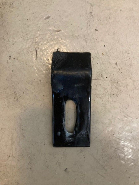

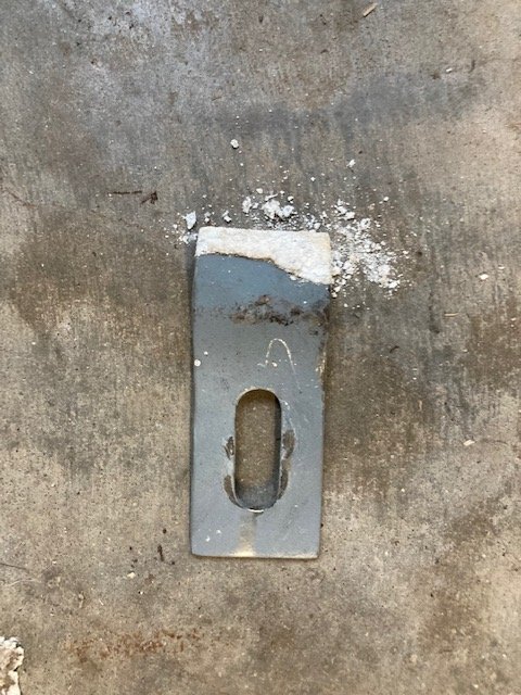

Plasti-dip battery hold downs.
My battery hold downs kept corroding so I plasti-dip'ed them. See the result?

Let us know how it works. A little baking soda in water from time to time will neutralize the acid. Just don't get any inside the cells.

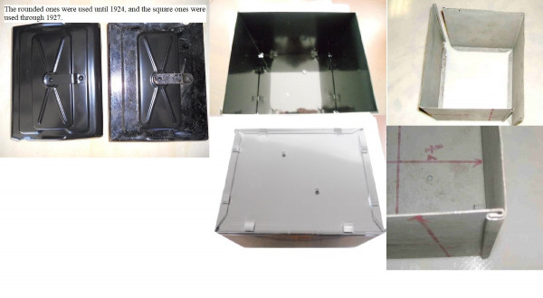

Help me learn .... is all this required for an "original battery box" configuration? Found info that you made them http://www.mtfca.com/discus/messages/59 ... 1475281772 http://www.mtfca.com/discus/messages/41 ... 1409322400Original Smith wrote: ↑Mon Feb 08, 2021 10:16 amIf you are using the correct battery box, all you need is a coat of black paint!
Also found this link with some drawstrings http://www.mtfca.com/discus/messages/29 ... 1205077586 Is it correct (except for the bottom seams). Material used, thickness etc I need to one - have a repro lid

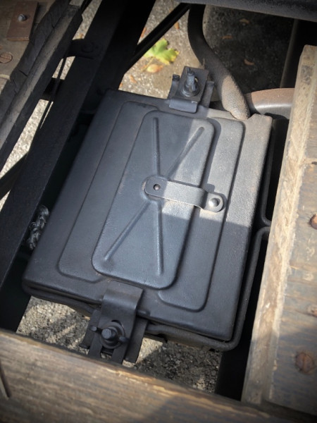

Re: Plasti-dip battery hold downs.
Here is the battery box and lid in my 23 runabout. One before the body was installed and also with the body installed and the deck hatch removed.
