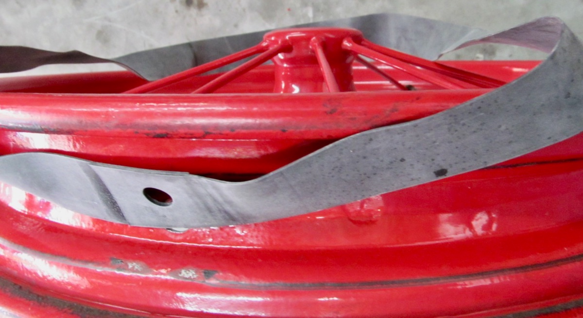

Rim strip on Ford wire wheel, strip fits into the drop center well.
