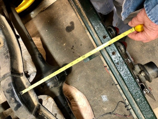

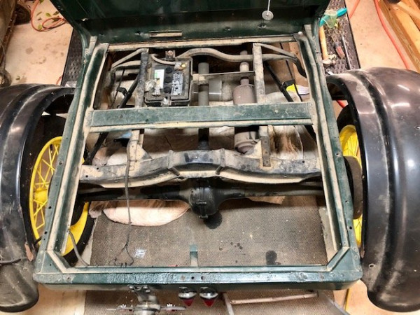

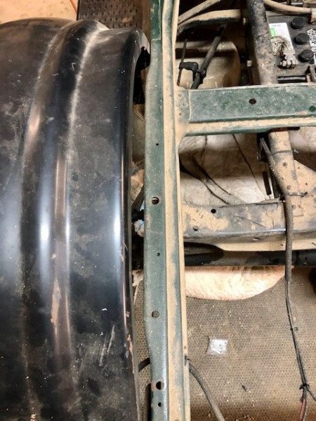

Attached are some photos I took of my roadster body mounted to the frame. The body is green so you can see the difference in the body and the black frame. The distance from the rear crossmember and the rear of the body frame is 16 1/2 inches. When you extend your body frame you need to narrow it down as shown in the photo so that the fender is positioned correctly.

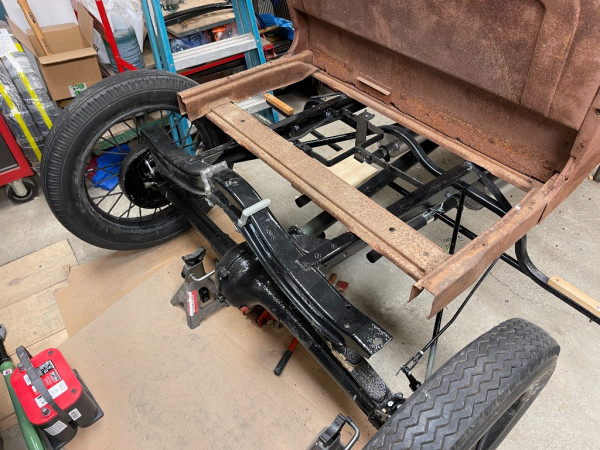

Here is what I have
