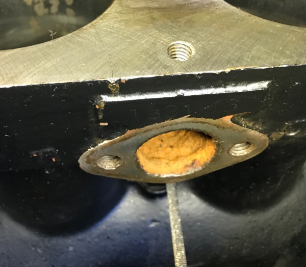

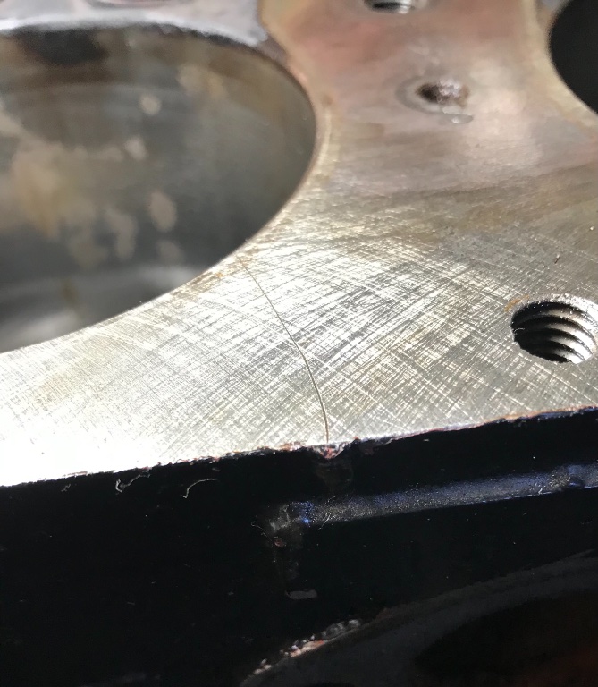

I recently purchased a 1916 Model T from an auction house. It appeared to be a recent restoration and I was concerned about the engine. I had it shipped to my home and I noticed no water in the radiator and fuel tank was dry. I drained the engine oil and found water in the oil. I thought it might be a head gasket, but after removing the head, I found the block to be cracked, right over the water inlet. I was wondering if you could put me in contact with an engine rebuilder familiar with model T's. I live in Southern Maryland. I would like to pull out the engine and give the motor/transmission assembly to a reputable rebuilder. Not sure if the block can be saved or if it has to be replaced. My guess is the top radiator hose leaked, engine got hot, and the block cracked. Appreciate any assistance.

Post some pictures of the crack. If its a crack between a bolt hole and water passage, it might not be a big deal. A considerable amount of water can be found in crankcase oil of cars that haven’t run for a long time and it can be condensation, not necessarily leaks.

That can probably be repaired but pretty sure it will need a sleeve as it goes to the cylinder. Are you sure its cracked? Looks like a scratch as its very straight. Cracks tend to be jagged

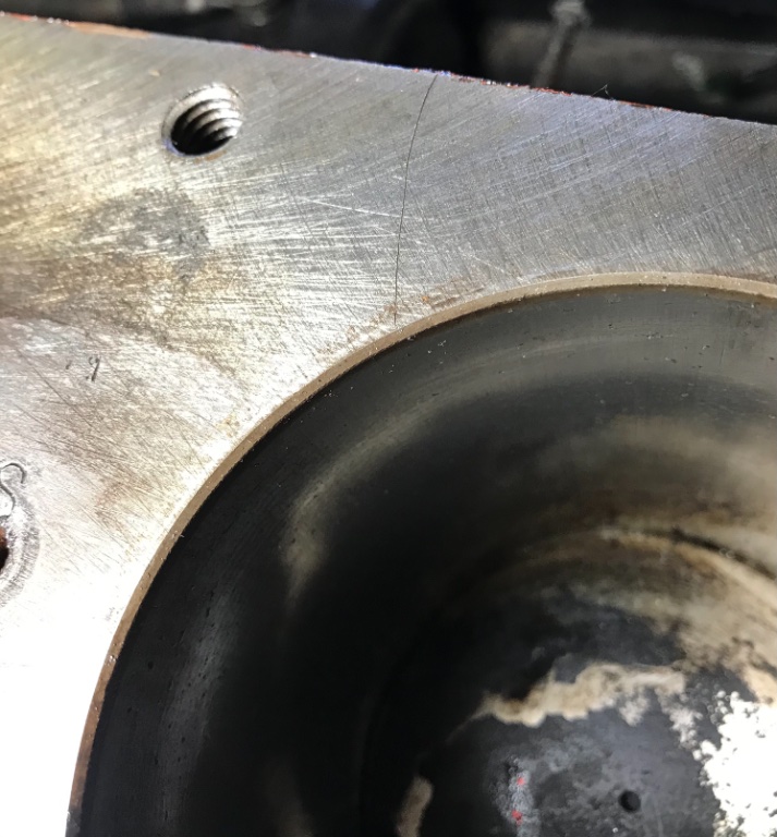

The crack is big enough that you can snag your finger nail on it. I cannot see it on the wall of the cylinder. Not sure if it is visible from the outside of the block. I will need to scrape off the paint.

Are you sure the cylinder hasn't been sleeved? From the photos, it may have been. Often, over the years, cracks like that were 'repaired' by sleeving the cylinder and nothing more. Metal stitching the surface would be an improvement. However proper sleeving of the cylinder is a 'fix' that has worked for many years on many engines.

WOW! Thats a big crack in an unusual place. In one of the photos it looks like there might already be a sleeve in the cylinder. Can you verify?
Can you see the crack extending down into the cylinder itself? If there is a sleeve in that cylinder, then the water is likely leaking to the outside of the block and migrating down and into the valve gallery.

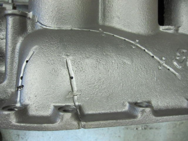

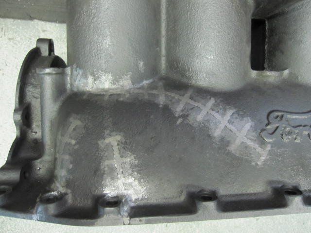

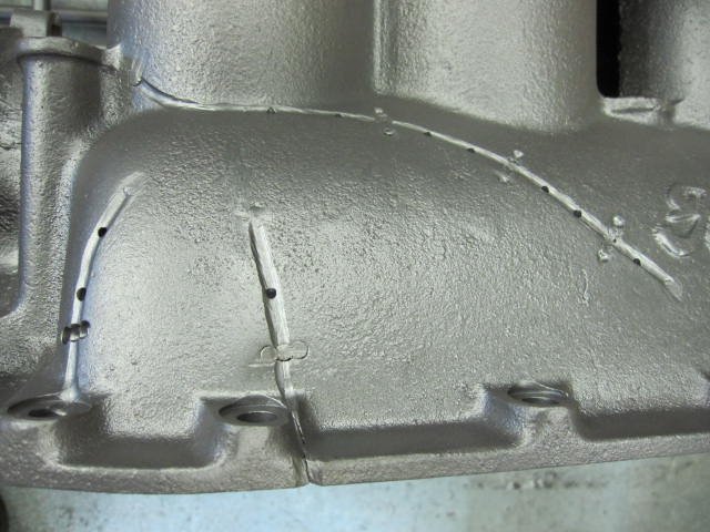

I have enclosed two pictures of a 1912 Model T block that someone tried to repair with JB weld and our metal stitching saving the block.
I believe that's something we can fix.
If the block doesn't have a sleeve in that cylinder now it would need to be sleeved.
Which we can do.
- Posts: 4386
Re: Cracked Engine Block
A 1912 block may well be worth the cost to metal stitch something like that! A 1916? Not so much.

I want to thank everyone for your help with my recent purchase. As many of you mentioned, what I thought was a crack was actually a deep scratch. I filled the scratch with JB Weld, got a new copper head gasket, and had the head resurfaced. The head gasket must have been leaking really bad. All four cylinders showed signs of leaking out of the side and between #2 and #3 cylinders. Possibly the previous owner re-used the head gasket. With the help of Jim Golden, I got it all back together and running. Cylinder compression was 60-62 psi. The block may still have problems, but at least it is running and I finally drove it (first time ever to drive a Model T!). Thanks everyone!
