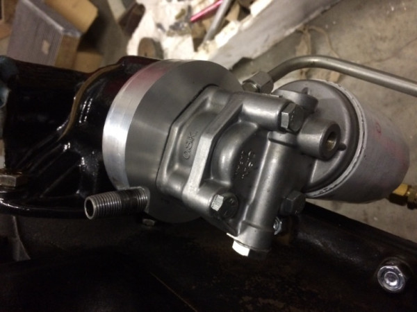

In my opinion the advantage of the B210 pump is the integral oil filter and relief valve. If you reverse it then these features are lost!! Lots of other pump options without these features.

My only gripe about the B210 pump is that the original generator drive gear gets cantilevered off the end of the B210 shaft with an adapter bushing. Turns out it’s not a very big gripe, since my pump has been operating trouble free for 10+ years and probably 10,000+ miles.

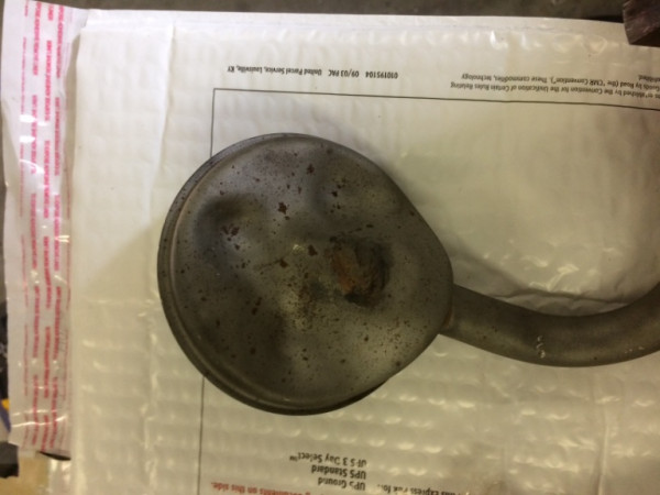

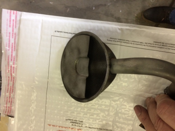

One thing that is important to do is putting a screen filter on the suction side, pickup tube also. Any lint from the bands going through the system will
clog up and you can burn up an engine or rocker system. We found this out the hard way on a DO.

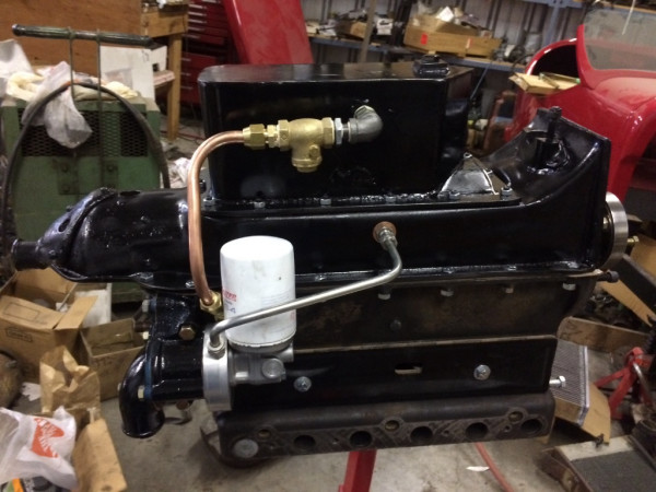

The pipe nipple pointing up is the priming connection. Typically only needed after a oil change or sitting for a long time

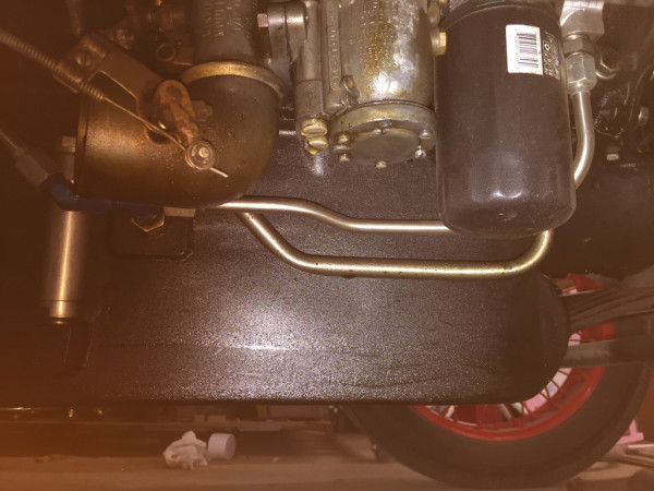

I like the sound of dumping the overflow to the transmission. Nice install Les.
