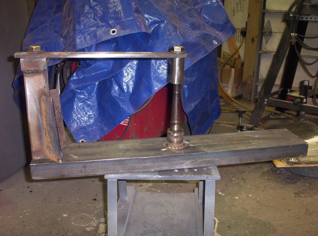

This is the trueing fixture I built I tried just welding a spindle to the channel iron, but about all that will allow you to do is to see the runout. If you need to use any force to remove runout, you will need some extra support. I chose to use an extra arm that screws onto the end of the spindle

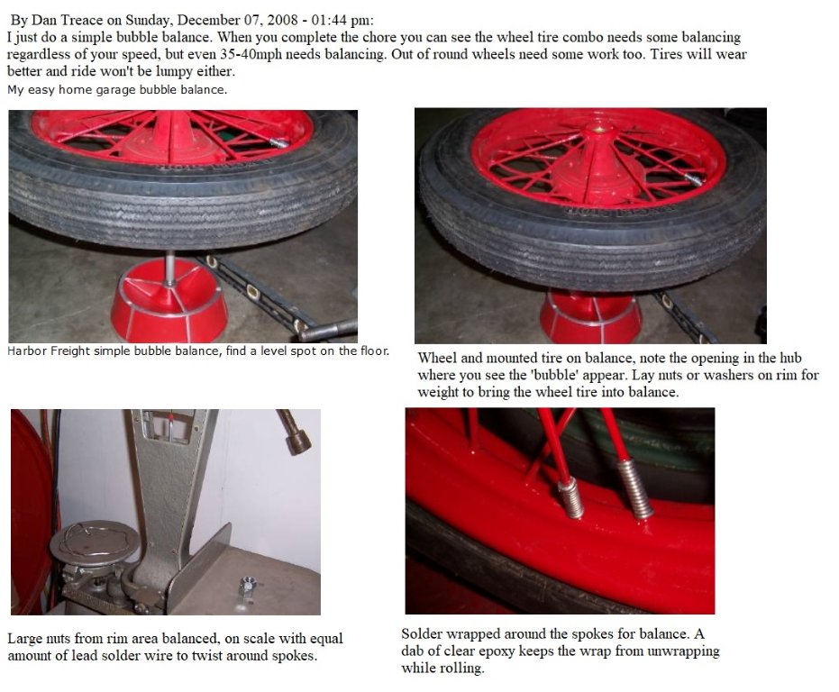

From a previous discussion http://www.mtfca.com/discus/messages/50 ... 1230312819

Wheel balancer is a great solution. I found it for less on ebay than HF. Glad I asked!
TRDxB2 wrote: ↑Sat Feb 13, 2021 12:15 pmFrom a previous discussion http://www.mtfca.com/discus/messages/50 ... 1230312819
