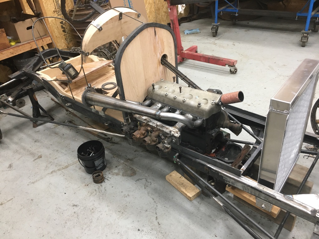

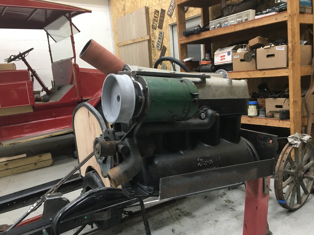

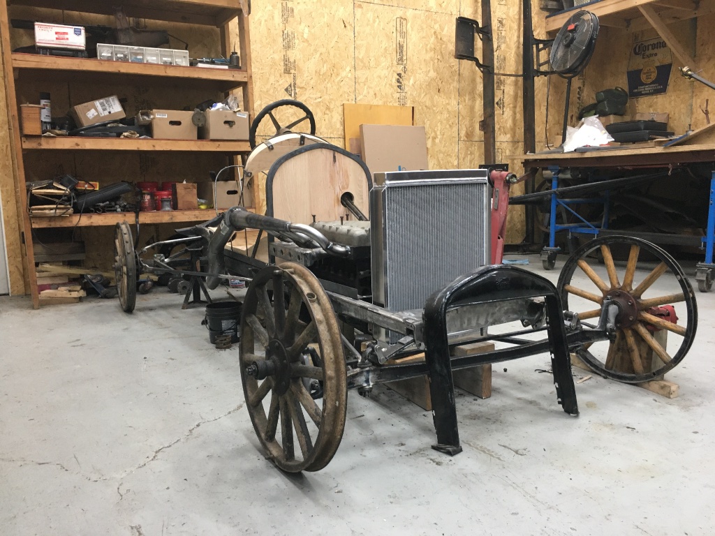

Post by Khill0105 » Sat Feb 13, 2021 3:59 am

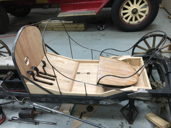

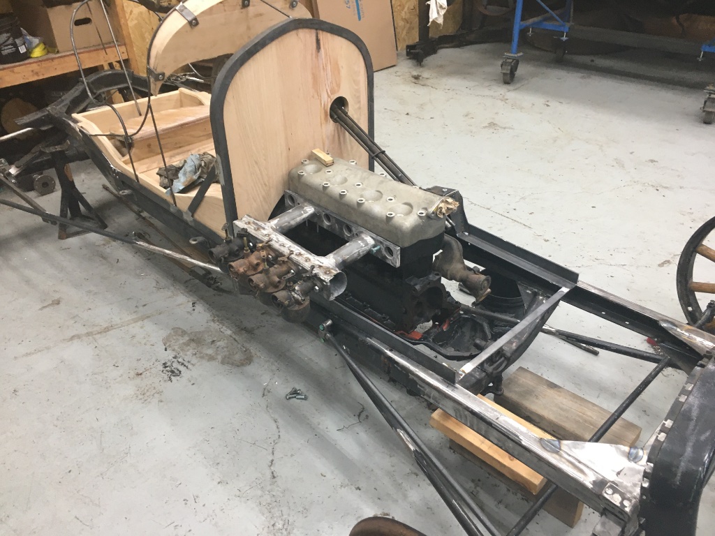

New to the page. My 13 year old and I have really gotten into model Ts. He came up with some rules for a build I wanted to do and thought I would get some expert advice. I’m building a 20s racer and the rules are the parts have to be model T or model T era. Parts could be made but had to be made the period ways. I will admit I cheated a bit because of my welding tactics. Just seeing what people think.

More pictures

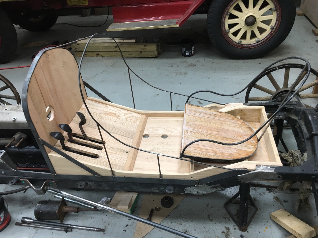

More pictures

More pictures

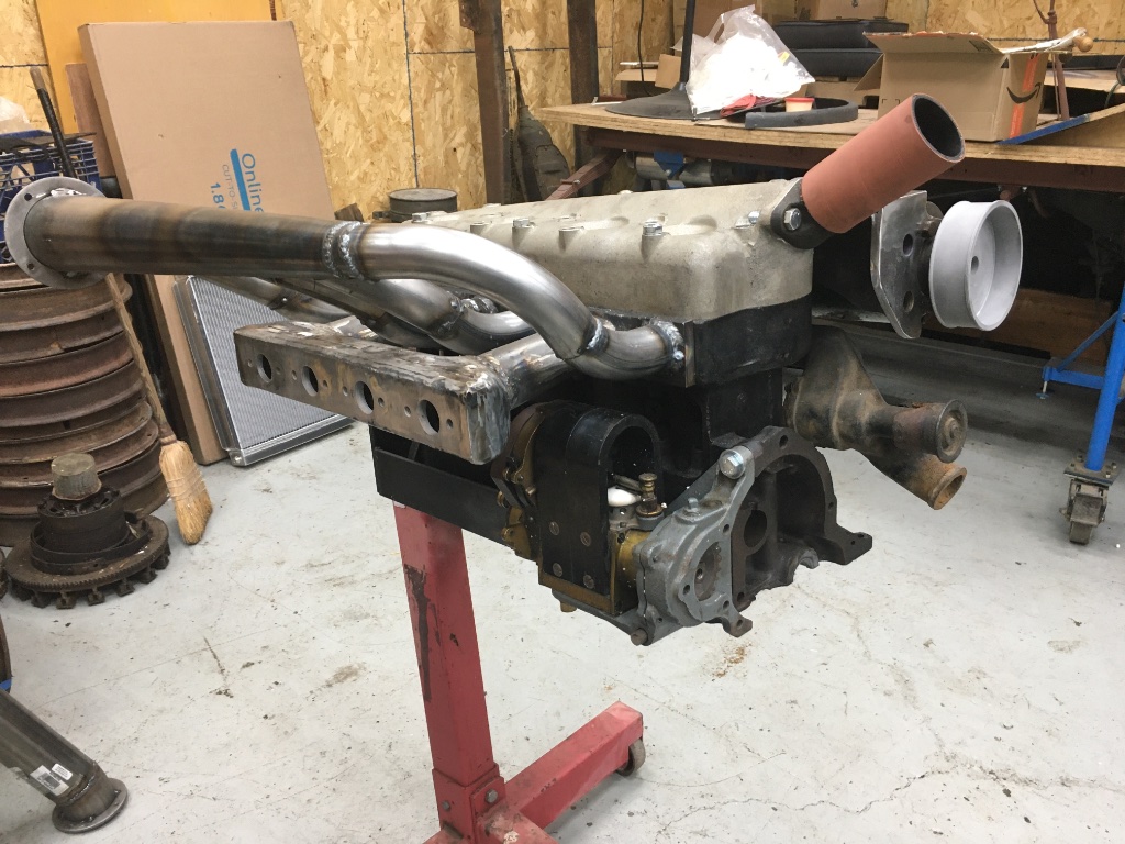

Re: 1920s racer
Post by blgitn » Sat Feb 13, 2021 8:05 am

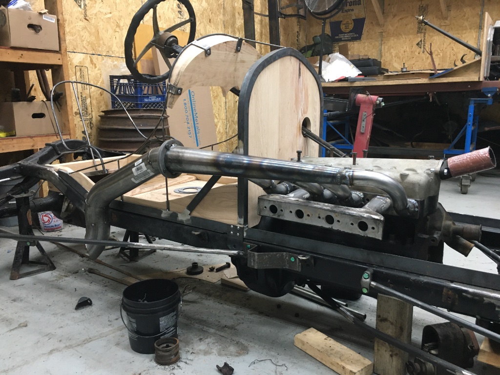

Beautiful work! I love the intake and exhaust! 😍

Looking forward to seeing more on the build. All interesting and looking good! Thanks for sharing.

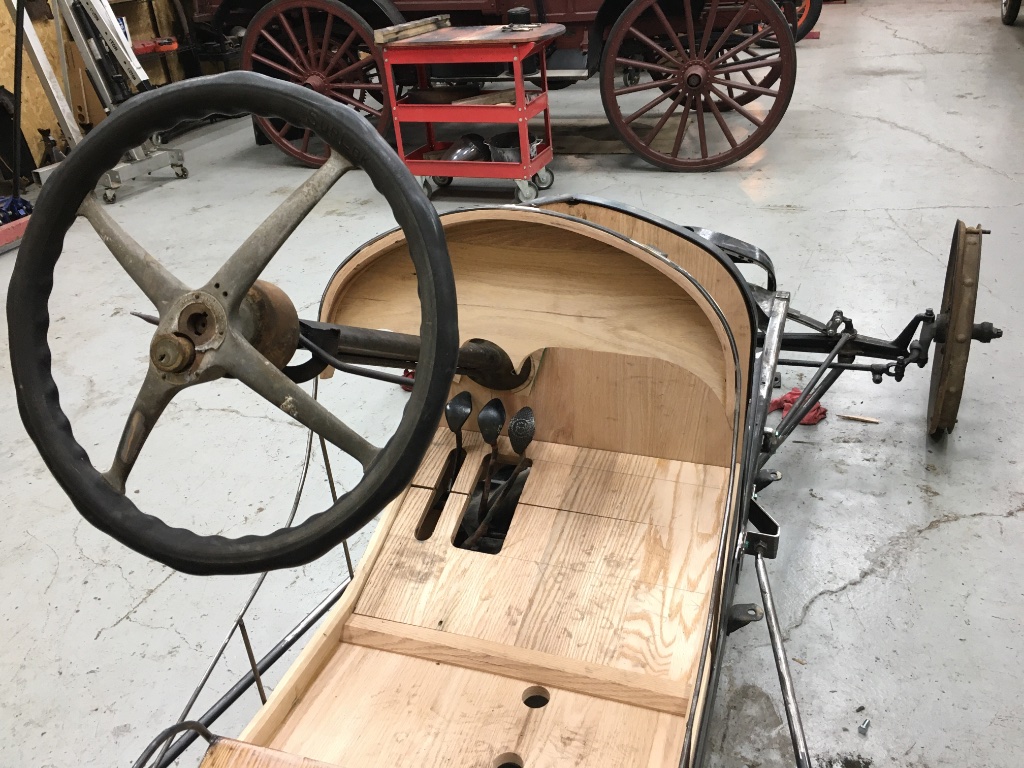

Re: 1920s racer
Post by Les Schubert » Sat Feb 13, 2021 10:53 am

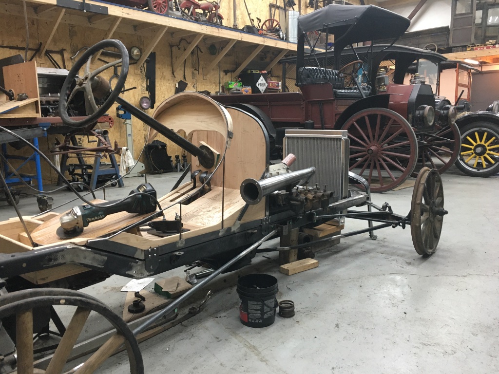

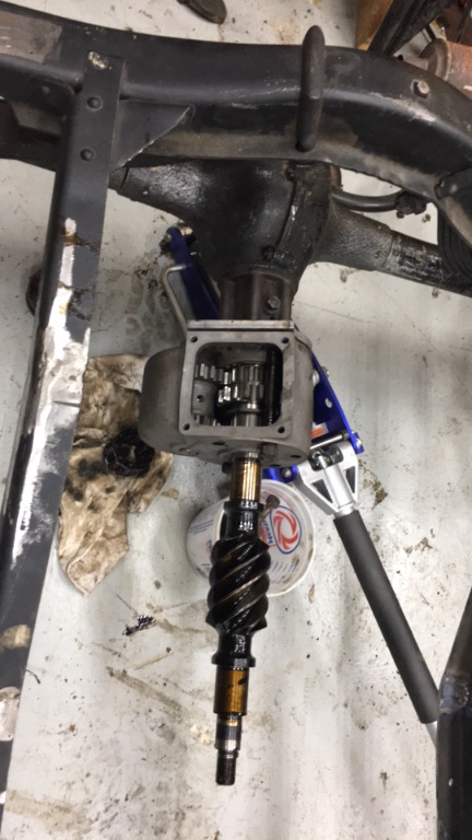

I’m really curious about the last picture with the worm gear???

Re: 1920s racer
Post by Kevin Pharis » Sat Feb 13, 2021 12:38 pm
I don’t recognize the trans off hand... but with a single sliding gear and the worm drive stickin out the wrong end... Is it safe to assume that we are looking at a truck underdrive installed backwards to provide overdrive...? Wouldn’t be the first time this has happened as this was an old salt lakes trick. But I question the ability of most T engines to pull the gear as many of the gear splitters for trucks are 40+%. Hopefully someone has counted the teeth prior to going thru all the effort to adapt

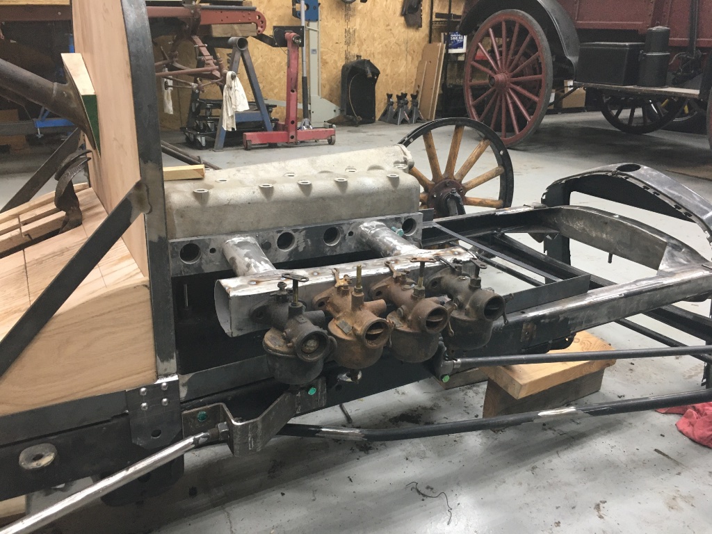

I’m more curious about the aluminum radiator...? And where the driver is going to put their legs with the motor moved back 18”...?🤔

Post by Les Schubert » Sat Feb 13, 2021 12:56 pm
Certainly a seriously BIG radiator!!

Re: 1920s racer
Post by Dan McEachern » Sat Feb 13, 2021 2:04 pm

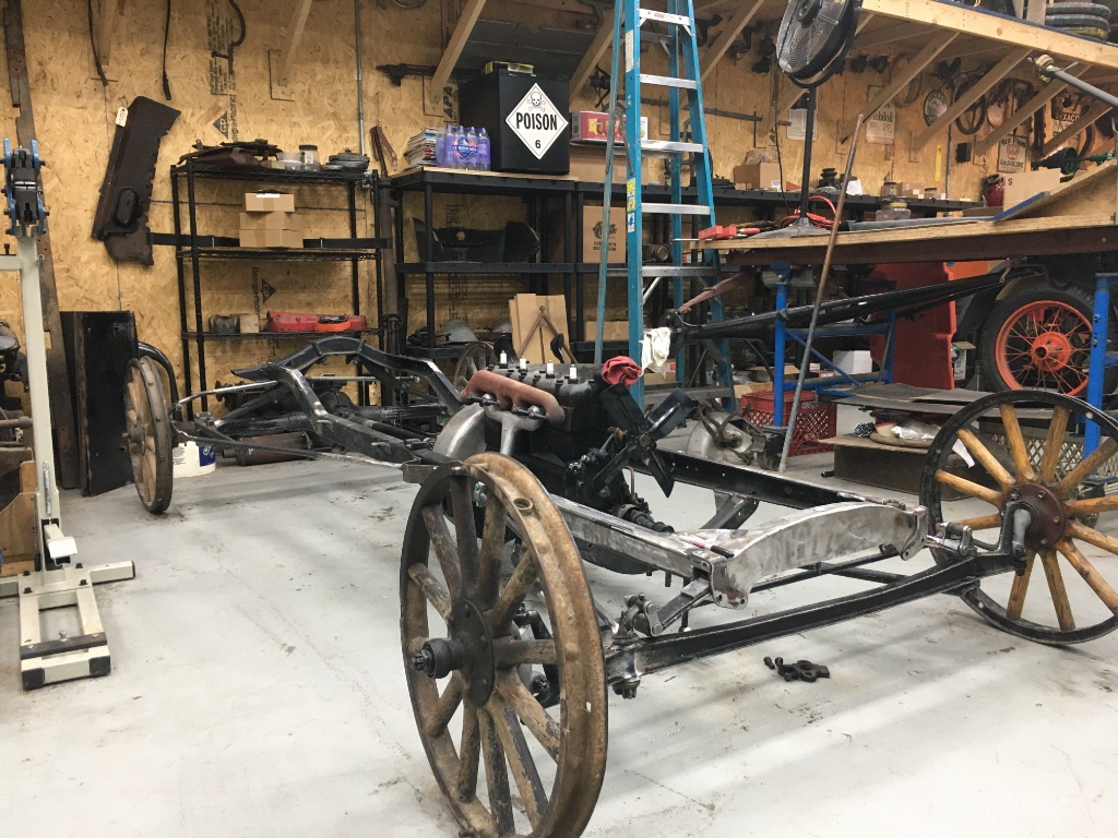

Nice job! a few comments on your radius rod anchor points- the rear radius rod ends need to be in alignment with your u-joint ball where they attach to the frame in order to prevent binding when the rear end moves up and down. Same with your front- looks like you have two different anchor locations for the upper and what appears to be a lower radius rod. These need to anchor to the frame in a single location. What you appear to have will bind up when the axles move up and down.
At least you are at a point in the project where you can correct this. Keep posting progress pictures!

loved the 4 Holley NHs.

Re: 1920s racer
Post by Khill0105 » Sat Feb 13, 2021 4:47 pm
Kevin nailed it. It’s a tt under drive turned around.
Thanks I appreciate the comment. I’ll take a better look at the geometry the rear seems to stay free when tweaking it but that’s not under load. That’s just cranking the motor over while in gear.

Re: 1920s racer
Post by Kevin Pharis » Sat Feb 13, 2021 5:00 pm
The rear won’t give you issues until the torque tube goes in. Then you will be triangulated, just as your front end is now
Thanks I’ll get into why better once I figure out how to get the cam to fit 😂😂 1.700 intake and 1.500 exhaust valves. 9.5 compression head. The head is slightly modified also.

Post by Kevin Pharis » Sat Feb 13, 2021 7:11 pm
9.5:1 is a lot for a flathead... not necessarily because of the bearings, but instead the lack of efficiency of the combustion chamber. I have a hell of a time with detonation at 7.5:1 in mine. Make sure your cam has plenty of overlap to bleed off some of the dynamic compression pressure

Post by Khill0105 » Sat Feb 13, 2021 7:33 pm
Definitely does had the cam custom ground. But I honestly don’t know much about Ts it may not be enough over lap. This motor is going to be a test motor just so I can learn things the hard way 😂😂 same with the intake. It may work it may not.

Re: 1920s racer
Post by Les Schubert » Sat Feb 13, 2021 7:43 pm
With the 1.7 intakes what are you running for a head gasket? Conventional one is going to be REALLY close to the valves!
I have run a T engine with a VERY aggressive camshaft and ended up creating 4 intake ports to get a decent bottom end torque. Pulled strong to 4500 rpm where the valves would start to float with stock T springs.

Post by Khill0105 » Sat Feb 13, 2021 8:13 pm
Correct there isn’t a head gasket. Stock ones won’t work. I’m going to either make one or o ring the block. I really haven’t gotten far with the engine. I’m still figuring out the chassis and drive line. But as for the porting I did the same. The intake is oval but i machined out the ports and filled them back in creating 4 ports basically. When I get back more into the engine I’ll post some better pictures.

Are you planning on running those carbs or are they just there for mock up?
Just mock up 2 are nh 2 are Kingston.

To the model T engine gods. I’m a fabricator, machinist, and a pretty good engine builder, I should say modern engine builder.
I really don’t know much about model T engine’s. So any advice, questions, or ideas, are welcome. I’m trying to learn the engine as I go. As far as I am concerned. I’m really pushing my luck with its ability. But experiments are how you learn.

Post by John Warren » Sun Feb 14, 2021 11:40 am
I had noticed that you are looking at using a tt aux trans backward for an overdrive. What do you end up with on final? I think that the overdrive is a great idea.

Post by Khill0105 » Sun Feb 14, 2021 6:04 pm
I ended up with a 1.75 to 1 over drive which is a bit much but I’m still going to give it a try.

Post by Henry K. Lee » Sun Feb 14, 2021 6:20 pm

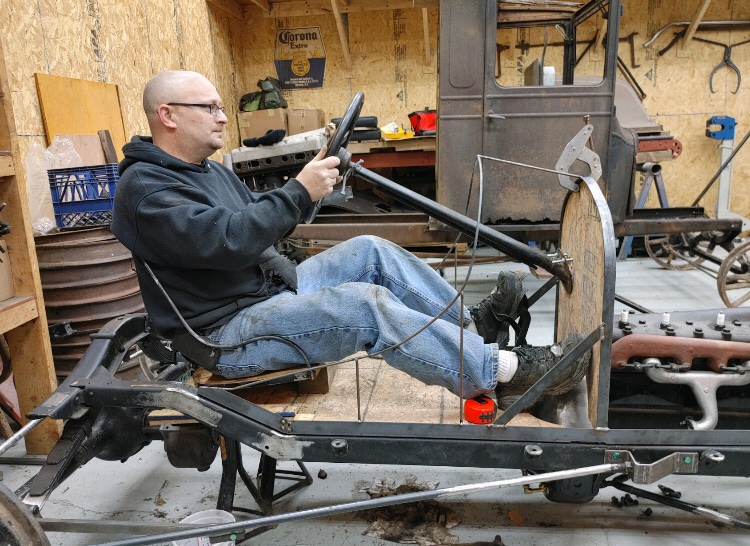

Might want to calculate your final drive @ 55 mph to engine RPM (1750 RPM flat head), (2000 RPM overhead) is in the sweet spot. Possible 10, 9, 8 tooth pinion gear would get you there depending on your outer circumference of the tires being used. You will need a lower support coming from the top of the oil pan attachment bolts to help support the extra weight from that intake combo. They like to rip out with all that mass. You have a lot of intake volume there too, do not know what method you are using to calculate volume (manometer pressure?)or are you installing "Chokes" and going for appearance? Looking interesting Cool!

Post by Khill0105 » Sun Feb 14, 2021 9:25 pm
Hank
I’m going with the stock pinion for now. But I believe you’re correct I’ll be going with a smaller pinion eventually. As for the intake ( I really should have taken pictures) the inside is baffled. Basically two carbs for the front two cylinders and two for the back. It does have an impulse port on the inside to try to equalize the intake pulses. I’m really not sure it’s going to work. Just an experiment to learn from.

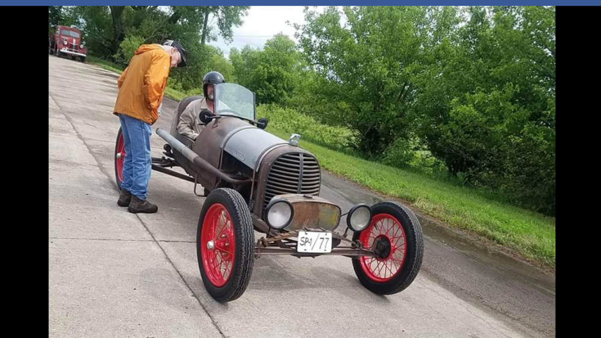

Post by Khill0105 » Mon Feb 15, 2021 2:45 am
What I’m going for kinda

John Warren
Posts: 1071
Last Name: Warren
Location: Henderson, Nevada
Re: 1920s racer
Post by John Warren » Mon Feb 15, 2021 10:04 am
Bobtail racer, Nice. You can look at my build on the forum, Race Car Project. Thank you for sharing your build. Love seeing stuff like this!

I just did a little math and at 60mph with standard T gears (3.63-1) the engine is turning around 2450 rpm. With a counterbalanced and pressure oiled system no problem.
At 100 mph around 4,000 rpm. Again quite doable.
I really have to question the MONSTER overdrive!

I agree with you it may not work I’m just trying things. Honestly I’m not sure about the hole build. I know nothing about Ts I have a few but there all stock. Basically this is all an experiment and learning lesson for me. I just really enjoy building things and trying to figure stuff out.

Post by Khill0105 » Mon Feb 15, 2021 3:54 pm
Bobtail racer, Nice. You can look at my build on the forum, Race Car Project. Thank you for sharing your build. Love seeing stuff like this! IMG_1932~photo.PNG
That’s really cool. Love it.
