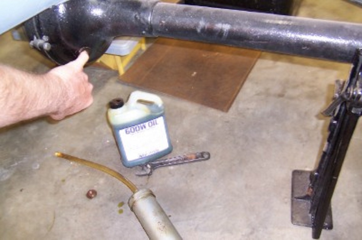

I put a drain plug in every axle I rebuild and recommend changing the axle oil every season. I believe it makes a huge difference in the longevity of the rear axle components. The drain is in the right side housing at the lowest point.
- Posts: 5511
Re: Change oil in the rearend?
Nice job Adam. I just drill and tap mine and do the same to all the rear ends I do. Unless the engine oil has been flowing down the tube and over filling and with the amount of driving I do in a normal season, never really worried how often it got changed.

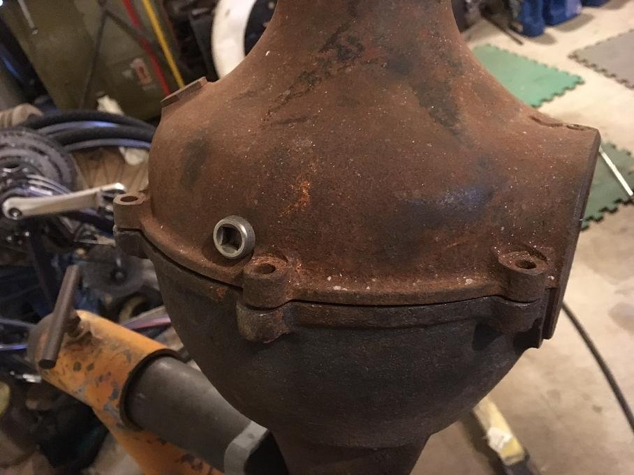

I like the idea of a drain plug. I s it difficult to drill and tap. Is there enough material in the case wall to tap? Would grease on the tap to keep metal out? Would it be tapped pipe thread or macnine thread?
John Warren
- Posts: 1071
- Last Name: Warren
- Location: Henderson, Nevada
This is what I do to the ones I overhaul. Drill and tap for 3/8 npt

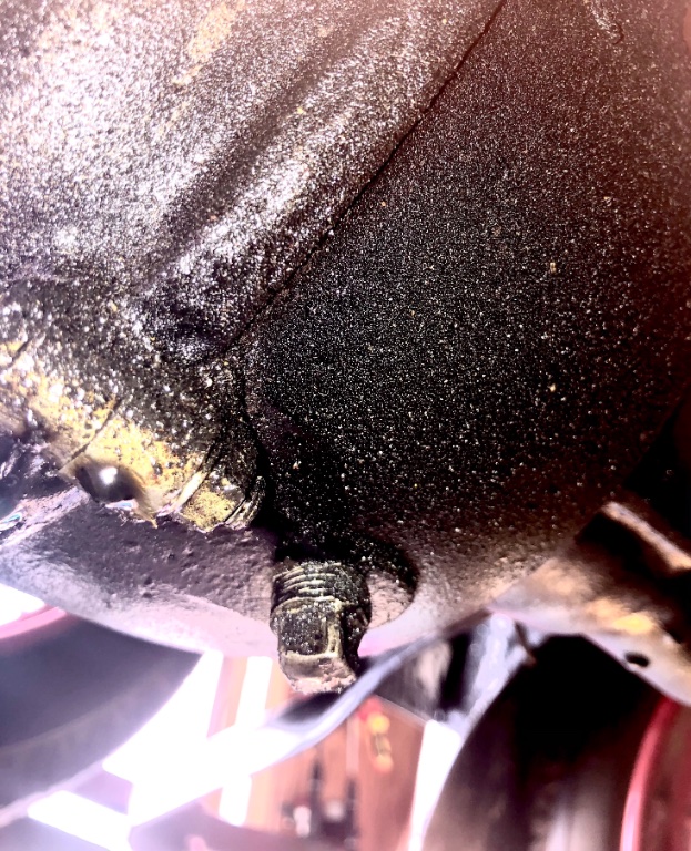

Henry didn't add a drain, only a fill hole. The Instruction Book states to check (every 1,000 miles) and add if level is low. I do that each annual inspection, and add if needed, most times none is needed with modern inner seals. If your rear axle drips and leaks, then check more often.
Now if you feel inclined, most all of the old 'free' 600W can be pulled out of the oil fill hole with suction gun, run the T to have the rear end lube warm helps to drain, just like engine oil should be warm to change. Then replenish with new using the suction gun. Have done it about every 5 years or so.
Now my Ruckstell has a drain from the mfg. on the Ruckstell housing. So that 90W pours out pretty quick, and can pour in a new quart, into the Ford side fill hole, with the nozzle of the container. Have done that annually, if a lot of tours that year.

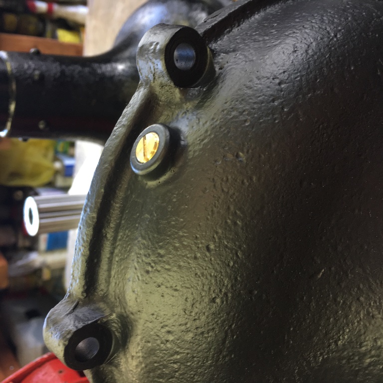

If drilling & tapping and adding a drain plug, it seems like perhaps a magnetic drain plug would be a good idea, not only to hopefully attract ferrous metal particles that occur from future normal wear, but also in case any metal particles are inadvertently left in housing from drilling. What do you think,.....???
- Posts: 5511
Mine is only tapped for 1/4" pipe thread, maybe takes a little longer to drain but works fine. Any larger then adding a support might be good. The casting is not real thick so 1/4"PT is good enough. As the size goes up the thread count goes down, so would have less thread to engage in the thin casting too seal.

Mark. You’re right. The pumpkin wall is very thin. Could you build up the lower drain plug area with a 1” diameter mound of brass brazing, then drill through the brazing into the pumpkin then thread the hole for the plug? This way, you could have a bigger plug. Jim Patrick
- Posts: 5511
You could do like Adam shows in that post, but the 1/4" works fine so why go to all the extra work.
OK it does look nice doing it that way. By the way, I use an Allen head brass plug, so it does not stick down any more then it has too.

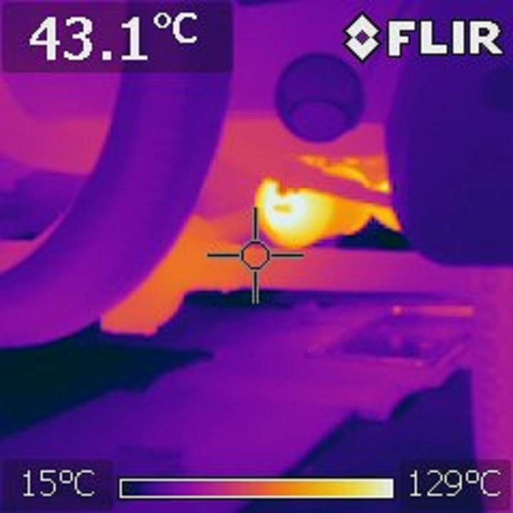

Jimjiminbartow wrote: ↑Sun Feb 14, 2021 6:21 pmDan. Does running the T create enough friction to warm the rear end oil? I would think that using a heat lamp or heat gun would warm the oil more efficiently than running the T. Jim Patrick
Yes. The action of a warmed up T will cause a rise in temp in the operating systems. Draining engine oil is best done by warm oil. Run up to operating temp, then let the T cool down some. Otherwise the oil will be too hot to handle
This thermal image was done many years ago, I think by a poster from down under, don't recall who to credit. But you can see the rear housing warm, as it also gets blasted by hot exhaust gases from the muffler.

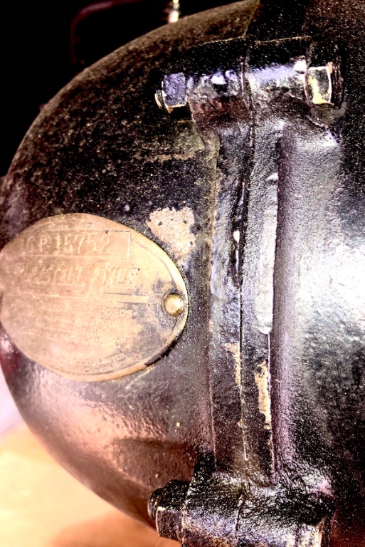

I'm curious Dan T. - how did you determine that Ruckstell (mfg.) installed a drain on that housing ? I have seen a "boss" in the housing casting but never a "factory" plug - I've built over a dozen Ruckstells & have yet to find a housing with a factory drain.
- Posts: 4062
RajoRacer wrote: ↑Mon Feb 15, 2021 10:50 amI'm curious Dan T. - how did you determine that Ruckstell (mfg.) installed a drain on that housing ? I have seen a "boss" in the housing casting but never a "factory" plug - I've built over a dozen Ruckstells & have yet to find a housing with a factory drain.
Assumed to be mfg. installed, maybe this was a far up North thing? My axle is Canuck
- Posts: 5517
Interesting - thanks !
