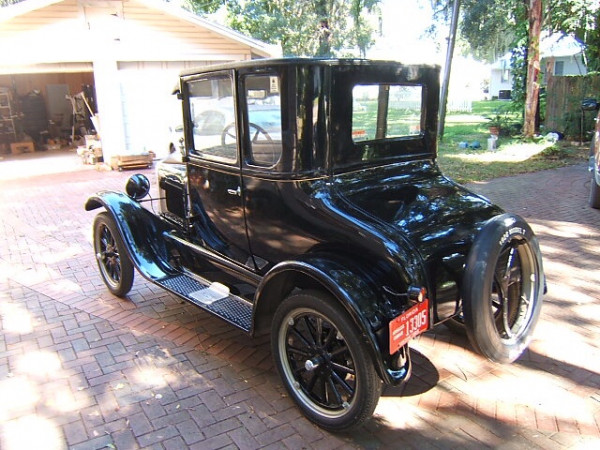

If the main reason you are wanting to buy this car is to keep it in the area, whether it is in good condition or not should not matter. If you don’t buy it, it may be sold to someone else and removed from the area and possibly wind up in a field or worse, as a hot rod project for some kid without any mechanical knowledge, a short attention span and a penchant for quitting. If I were you, I would go ahead and buy it and, once you own it, sort out all the details. The longer you wait, the more time the owners have to find another buyer, or change their mind, especially if they sense you are unsure of whether or not you want it or if your offer is dependent on the mechanical condition of the car. They have already approached you to sell it, so you should be able to get a good deal. The less they know about the condition (especially if it runs) the better the price you will get it for. If they know little about the T,have no interest in it and are currently anxious to sell it, but you talk about it so much as to generate a genuine interest in them in what they have, they may decide to keep it and you may lose the momentum and the opportunity. If you want it, be decisive, make an offer and buy it.
Don’t worry about finding parts, I have a 1926 coupe and there is no part that I needed that I was not able to find. At the age of 16, I bought my 1926 coupe in 1970 and it could not have been in worse condition. Covered in thick rust, dents and bullet holes through the sides with broken glass, rotten tires, rotten wood and a 4” high belt of rusted out metal all the way around the bottom of the doors and body, and not running, but otherwise, complete, it took me two years to do a total body off restoration from the ground up. Without the internet, or the MTFCA resources available today, I did it all myself, learning as I went from three Model T books that every T owner should have. Even in 1970, parts were easy to get and even easier now so that should not be a concern. Jim Patrick
PS. After 50 years, I still have the coupe.
