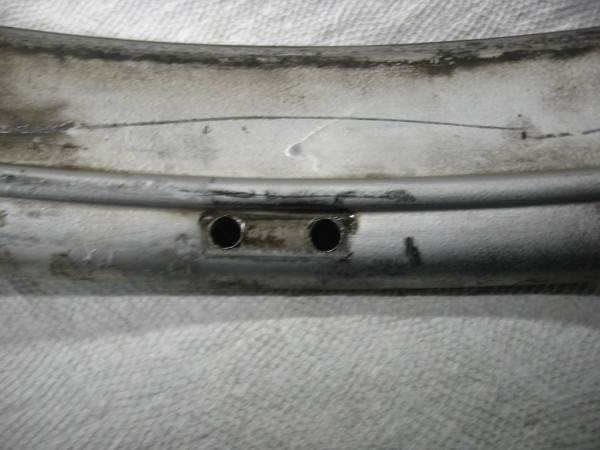

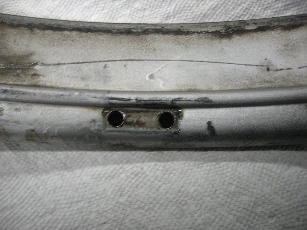

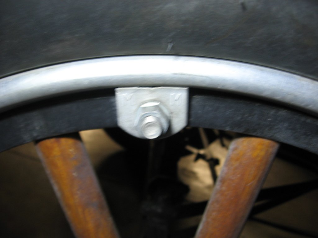

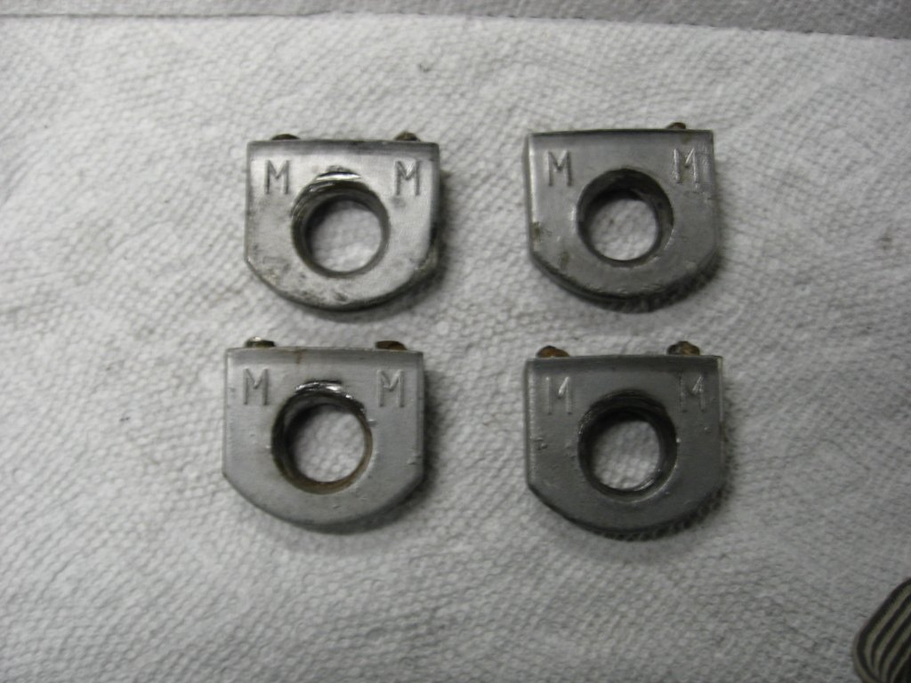

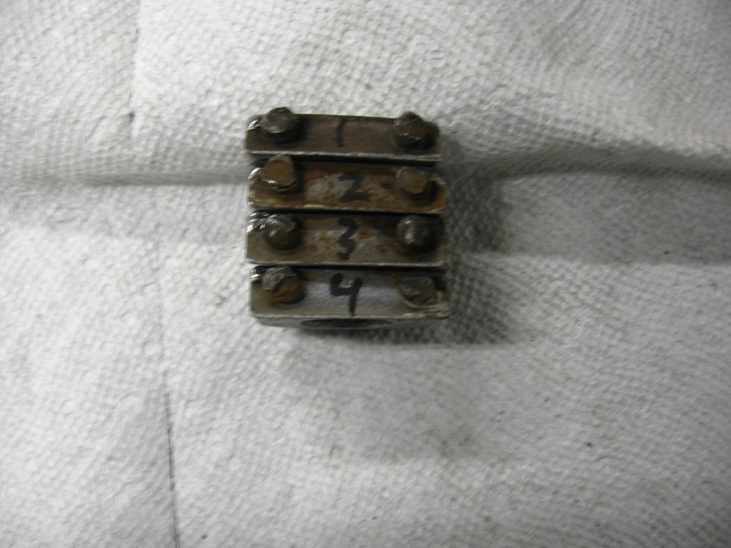

SAFETY WARNING for McLaren Manufacture 30 X 3 ½ Model T Rims purchased on 8/02/2007.
On Sunday February 7, 2021 while driving my 1919 Touring Car northwest of Sebring, FL on rural, washboard roads at approximately 30 miles an hour for several miles, I stopped to stretch my legs. Upon inspection of the rear driver side wheel, I noticed all 4 lug nuts had loosened. They were tight when I had left Sebring earlier that morning. After jacking up the rear axle to install the spare tire and loosening the rim bolts, all 4 of the rim lugs came off in my hand. These rim lugs are pressed into 2 9/32” holes each in the rim. (see photos below) Thank God for the stretch break and noticing the issue. I believe another few miles the wheel would have separated from the felloe causing damage and/or injury as well as loss of the rim bolts and nuts. My other McLaren rims have solid lugs attachments. PLEASE take the time to inspect these rims if you own them. I want you, your family and Model T’s safe and sound for enjoyable future touring.
RIM HOLES
LUG FACES LUG TIPS
GOOD WHEEL
RIM HOLES
LUG FACES LUG TIPS
GOOD WHEEL

FYI concerning the McLaren 30x3.5 “demountable” rims that Dom has had a very close call with. No question, that was obviously a close call and a disaster was averted.
As many of you know I purchased only the “wire wheel” portion of the McLaren wire wheel business. I do not manufacture any of the rims themselves. That said I too have purchased 21” split rims and 30” demountable clincher rims from American Vintage Rim which is owned by Mark McLaren. All of the demountable rims I have purchased from Mark had/have the lugs clearly welded in place before plating. The pressed in lugs must have been used in a pre-revision product. Thanks, Mike Lebsack

While that's clearly an issue, the lugs would have still retained the rim and it would not have let it come off. Demountable rims on other antique cars used lugs that were not attached directly to he rim, which is essentially what your rim became. What could have happened, is that the rim could have spun on the felloe while braking.

I would be checking other rims you have like that one by bolting them to the same wheel. If the rim/felloe combination is correct, all the four bolt have to do is maintain the wedging effect of the rim on the felloe. Fixed lug rims like that one are designed to wedge on the inner land on the felloe, with the lug standing off the outer face of the felloe. A mismatched rim/felloe may have the rim not being wedged on the felloe and the lugs become the driving/braking point.

The lugs came loose, and that allowed the nuts to come loose. The rim could certainly have come off in that case as the nuts were shed. Had the nuts stayed tight, the rim may have stayed in place. However, that would indicate that the lugs were hard against the felloe, and that in turn means the rim/felloe combination is not correct. That rim/felloe combination needs more investigation.
Externally welding the lugs back in place will not lead to a tidy looking fix. I would slot the rim between the two holes and use a heavy weld through the slot to weld the lug on from the inside. It would appear that in 'riveting' over those round feet on the lug, there was not enough material displaced to make a strong mechanical joint.
