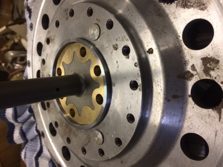

Getting ready to install the Kirk Wright flywheel and I realized that it wouldn’t reach to the crankshaft flange and I don’t trust just the dowel pins. So bored it and installed a ring.
Yes the transmission shaft is pointing the wrong way right now!!

smart fix !
