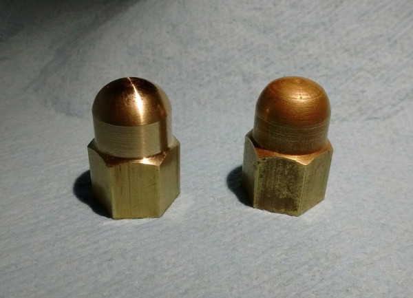

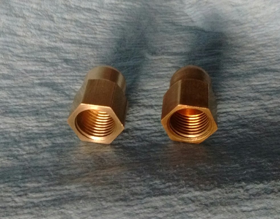

- Posts: 6790
Re: Stromberg MB1 carb-good for anything or is it a paperweight?
I make those Float bowl nuts. Two photos showing comparison of mine vs original:

I'm with Scott. I make those float caps by the handful. Piece of 1/2 260 brass hex, drill it, tap it 1/2 24, part it off, diameter reduce the side and taper the end. Clean up any tool marks, run it over the sander, throw it in the drawer. I dunno how many I've made but it has to be in the hundreds. About the only thing I use 1/2 inch hex 260 for. Missing from probably 75% of the Stromberg at least. I also make the early style for the cast brass float bowl covers. Not much demand for them.
