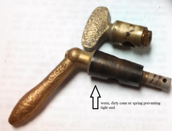

There may be an issue you need to resolve. Reason for the questions: The fuel to the engine is gravity fed so you need to take some steps to stop the flow. All things fixed - you should not have any smell (may some just after the engine is shutdown.
I have assumed that this is about the Model T in your MTFCA profile 1922 Center Door Sedan
Sounds like you have a leak in the sediment bulb.
1. assuming that you shut off gas at the valve on the gas tank - does the petcock leak?
2. do you have a shutoff valve on the fuel line nearest the carburetor?
3. after you park in the garage is there any sign of leaking under the carburetor bowl.
4. wrong sealant used on sediment bulb
Pitch the carpet or if you need it wash it.

Like others said, you gotta track down the leak first. If it's sourced at a device with threads, like the carb bowl drain or bowl nut, or the petcock on the "potato", get some Loctite 567 and judiciously coat the threads. It'll stop the leaks. I use it on all mine.
