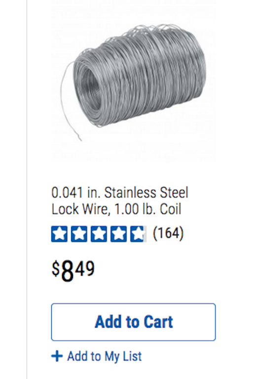

Topic author - Posts: 7411
Re: What safety wire?
Excellent! There's a HF store just a half hour down the road. That will save me some time. Thanks to all.
https://www.harborfreight.com/search?q= ... ock%20wire

Hmmm,....call me crazy, but somehow, the two terms,...."safety wire" and Harbor 'Freight don't quite sound quite right to me!

2nighthawks said
"Hmmm,....call me crazy, but somehow, the two terms,...."safety wire" and Harbor 'Freight don't quite sound quite right to me!"
I wasn't going to say it Harold, but dittos ! The real thing is only a buck more.
