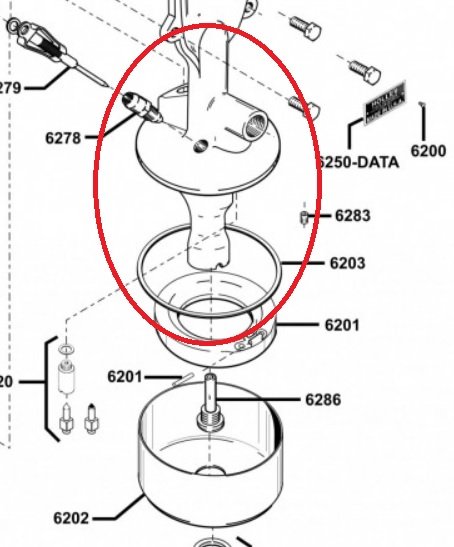

I plan to refresh the threads on the cast iron section of my Vaporizor where the bowl mounts. What are the sizes of the thread taps I need to do all the threads?

Here are a few answers taken from some notes I made in 2012. These are us standard thread in inches and number of threads per inch. Before you purchase these taps, I would confirm correct specifications.
Part 6278 1/8" standard taper pipe thread (NPT)
part 6286 3/8"-24 threads per inch
part 6220 float needle seat 1/4"-32
6219-91 bottom bowl nut 9'16-24
6283 needle seat - I do not know thread specifications
good luck with your restoration, jb

Thanks for quick reply. Would like to know the last one also, anyone?

Needle Seat thread is 10-32.
