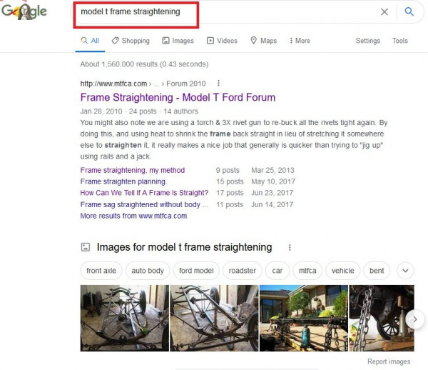

Several previous posts many more out there
http://www.mtfca.com/discus/messages/33 ... 1364403935
http://www.mtfca.com/discus/messages/70 ... 1495333835
http://www.mtfca.com/discus/messages/70 ... 1498475134
