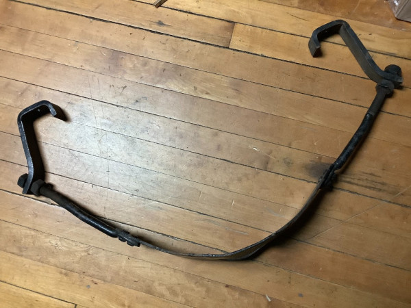

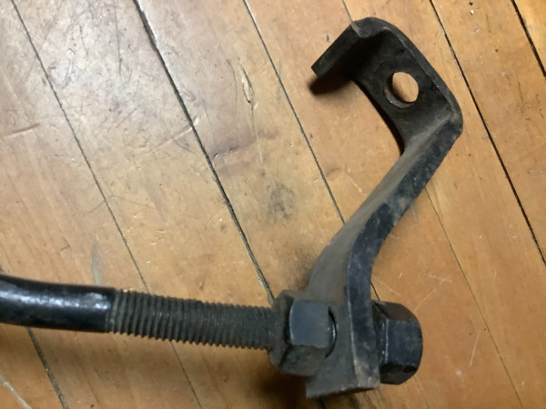

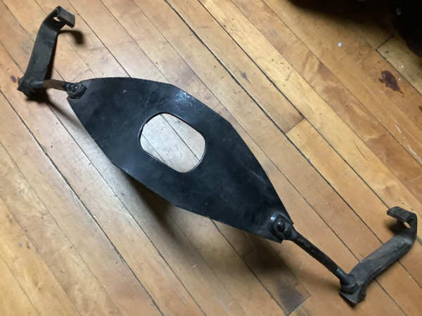

Some great guys on here have a photographic memory and a great collection of trade books. I’ve seen these in the past, but always thought they were homemade ends for the frame. That is, until I kicked up this NOS unit. Looks like it slips right over the head of the vertical pan bolt nut. Any idea of the maker? We may think of simplifying the ones we make, but we always like to give credit to the original producer.

I have one identical to yours but no name anywhere. Don’t put it too tight, it is merely a backup safety device only. Frank

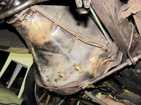

Frank, I’m intrigued by your statement “don’t put it on too tight. It’s merely a backup device.” it has long been my intention to affix a belly band under all my Model Ts to primarily take stress off pan ears. As such; I bottle jack the engine at the oil drain plug a little less than 1” and install its belly pan. I also insert a cutoff rubber from a truck mud flap between the crankcase and belly pan. Of course it has a hole cut out in the center for oil changes. Am I doing something wrong ?

Very interesting ....thanks for all the responses. Now I’m somewhat confirmed by my above-described technique. Rivets and braze after 100 years coupled with metal fatigue incentivizes me to partially remove weight on the 2 crankcase ears with a belly strap. And I do believe the 1/4” hard rubber between the belly strap and crankcase cuts down on vibration.. thanks all !

My drive to make these was getting an engine back from rebuild and catching a very small hairline crack in the pan arm. These can be still found used, but often the threaded portion is in bad shape. iMHO they should be snuggled up so they don’t move, otherwise the threaded portion will be damaged again with movement. That is our reasoning for providing ours with a thin piece of neoprene rubber glued to the bottom saddle. Regular rubber will not survive oil very well, in case you have one of those rare lizzies with bladder leakage. We have sold quite a few, available only through Snyder’s and Lang’s ( sorry, shameless plug )
