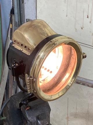

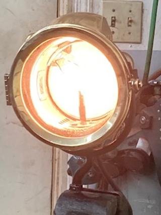

Post by Craig Leach » Sat Feb 20, 2021 11:31 pm
Mark you may be wrightbut window glass will reach over 140* in arizona in the summer time. I found 1926 chebby head light glass is 7 3/4" so I used one of hem I had. THe light looks OK after I got the mail box imprint out of it.
