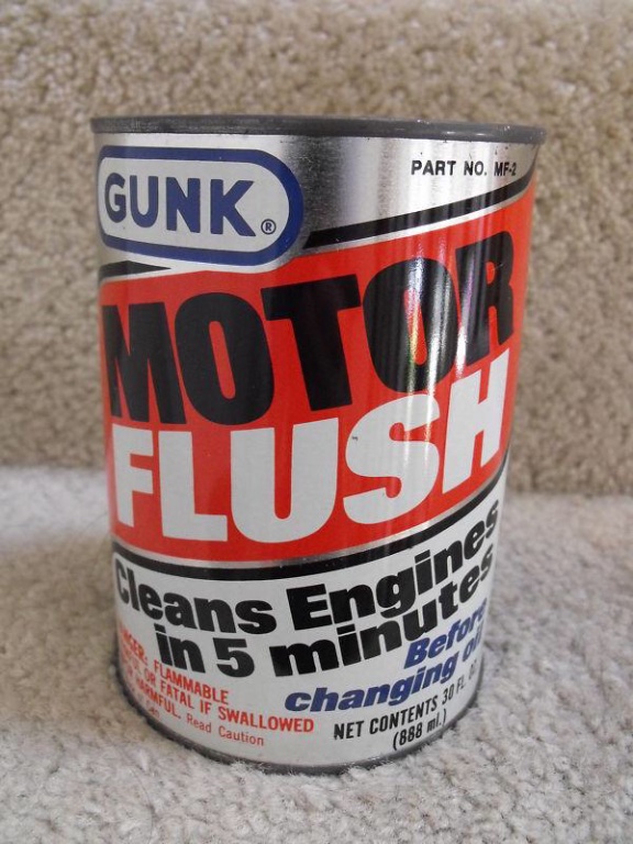

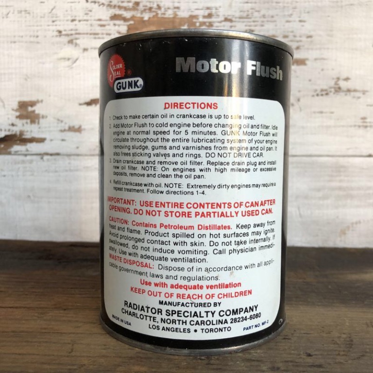

Re: Flushing?
Yes. “Motor flush” can be bought by the quart at auto parts stores such as NAPA , advanced Auto and Auto Zone. Add it to the oil, start the car and run until the oil gets warm. Supposedly the flush gets to all parts of the engine and cleans out the old oil in preparation for filling with new oil. When I did mine, I bought two quarts, did it once, drained some oil out, added another quart of flush and ran the engine somemore. Did a good job cleaning the inside of the engine before the oil change. Jim Patrick

Re: Flushing?
Is the “Motor Flush” less expensive than the same amount of cheap motor oil?
How can you tell what sort of job it does? Did you open up your engine and look?

Re: Flushing?
Yes. You can tell how much thick black goop would have been left in to contaminate the new oil by what comes out after the motor flush. To me, it is worth it, but to each his own. I am one of those Model T owners that baby’s my T and consider nothing too good for her so the cost is never a consideration if I think it will be of benefit. Thus far, I have been rewarded with 50 years of reliable service. Jim Patrick
