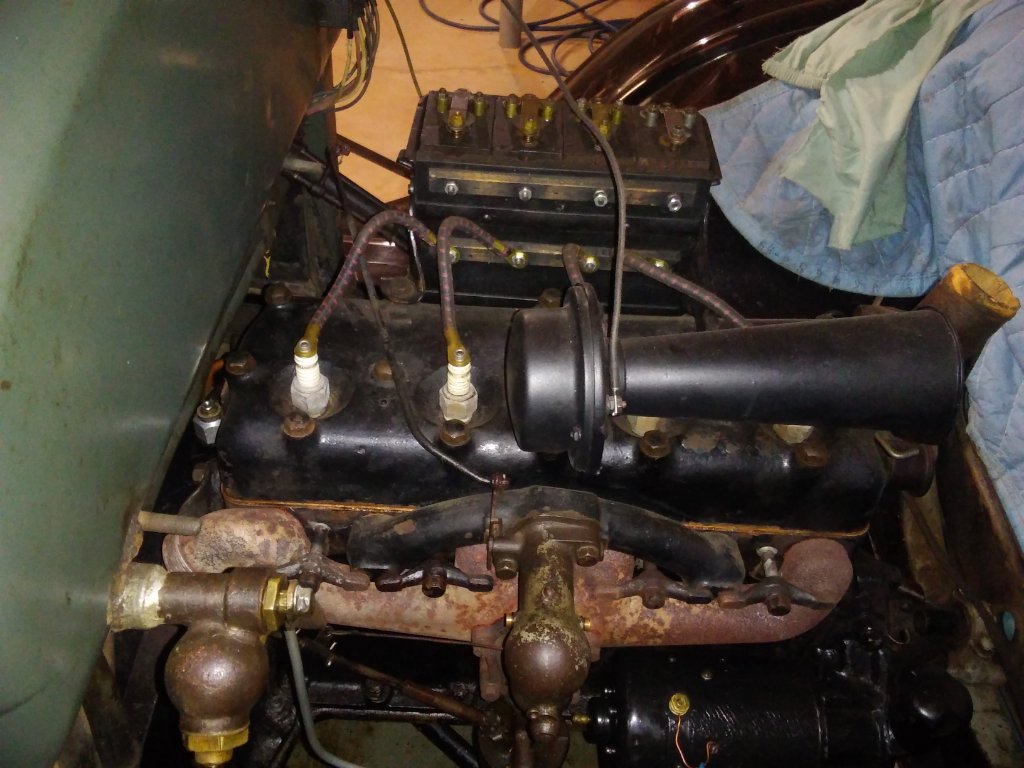

Post by TFowler » Sun Feb 21, 2021 9:16 pm
These pics are with spark and throttle levers fully retarded (up) on 27 (2 door sedan).
Throttle linkage rod lever is up (1 or 2 oclock) on shaft and stops on steering shaft.
Spark rod lever is at 1 oclock on shaft
