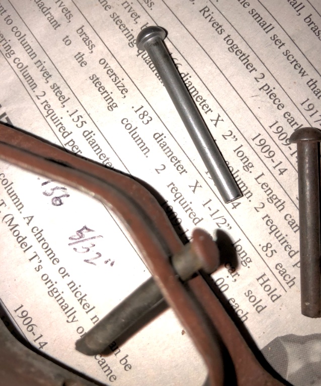

Thank you all for your help and input. I bought a set of rivets 3509RST from Lang's. I want to rivet everything back as original. I know that the rivets are made a bit oversize because the holes are usually worn and larger than original. But i go back to my original question: Why are the holes so small? If the answer is they came that way and the new rivets are oversized to compensate for a worn out hole and rivet I'm ok with that and I will drill out the tube and quadrant for the 3509RST rivet.
I also went and placed a 5/32 drill bit in the hole. That's to correct size. The rivet just looks too big But then again that could be to compensate for a larger hole.

Have used many of these rivets from Lang’s. They are all 5/32” like original. Catalog states .155” and mine on hand mike the same, including the original with its now flatted and angled head from rivet set.
Passes snug into original quadrant holes. Mike the rivets you got, they may be off, should be .155”

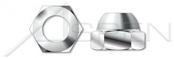

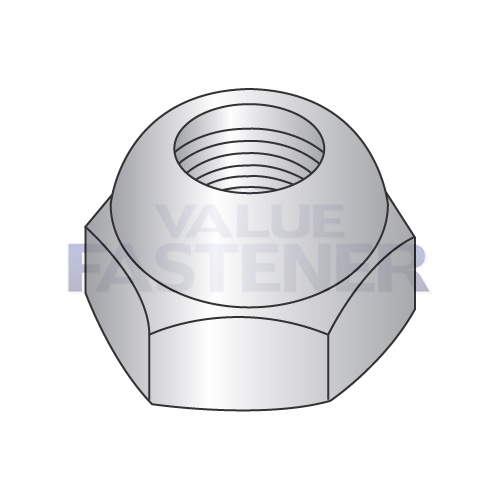

Allan. I would suggest an “open end cap nut”. Basically an open ended acorn nut that, when the dome end is positioned against the surface, will conform to angled or irregular surfaces. Jim Patrick
Posts: 7306
Re: Steering Column Rivets for 1926/7
Post by Allan » Wed Feb 24, 2021 9:09 pm
That'd do the trick Jim, but not that particular one. The draftsman forgot to run the thread right through!!!!!

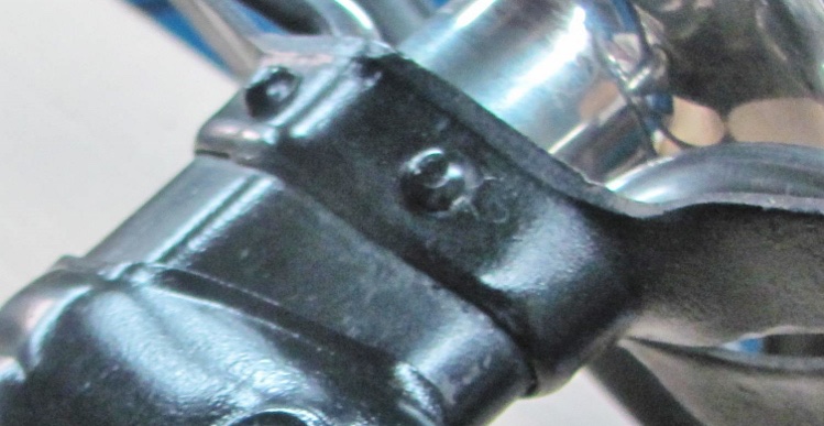

Just too Henry I am. Rivets are best at the quadrant.
Threaded screws or bolts, nuts, lock washers, can wiggle loose within the holes of the soft brass case, and all will protrude and would snag my hand, at times reaching under the quadrant. Smooth rivet head there is better.
My use is a pneumatic rivet gun, setting the rivets cold, bucked tight under the column and quadrant. Rivets placed into the softer brass steering case lock in better, due to the angle these rivets are placed. Fix is secure at this very important part, the steering gears are under the steering wheel. Make this assembly the best you can.

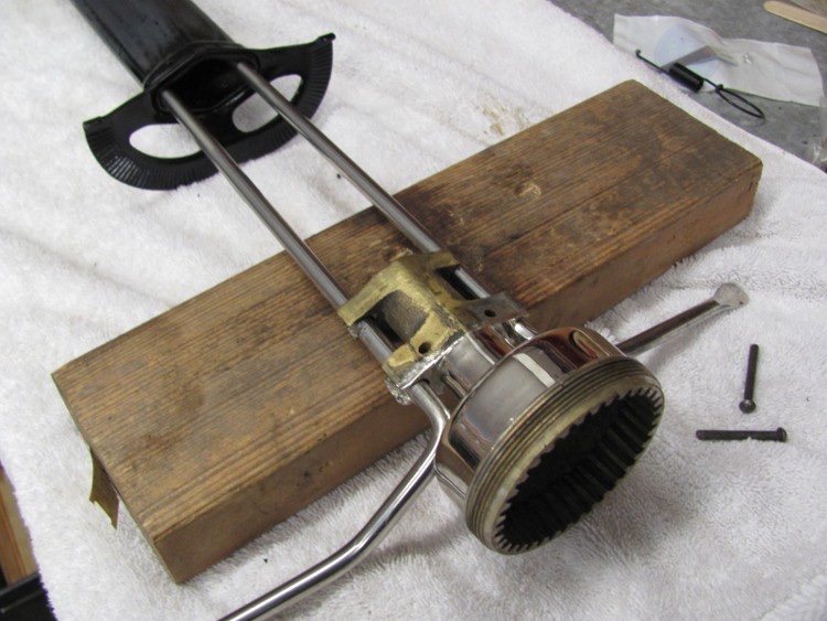

Guess one could do anything to the T steering column. But any wiggle at the quadrant/steering case needs to be fixed.
IMO, remove the old rivets, inspect the column for any crack, then replace the re-finished case using factory method of riveting.
Of course, welding is one way :)
welded up loose quadrant.jpg (59.04 KiB) Viewed 5084 times

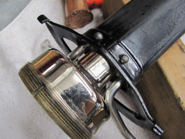

IMO, easy to re-rivet, and gives the best look and security, as in the one I did below:
